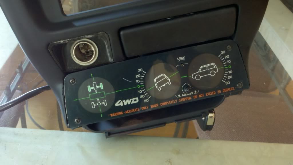

So I bought a Inclometer that Toyota used to sell in the 1st gen 4runners and Tercel's for $100. I wanted to graft it into the lower part of my center console. I didn't want ruin my faux wood trim so i experimented first.I tried it out on a extra Console bezel piece I had for 96-98 4runners.
I cut and bonded and painted and this is what i came up with.
Inclinometer1.jpg~original
Inclinometer2.jpg~original

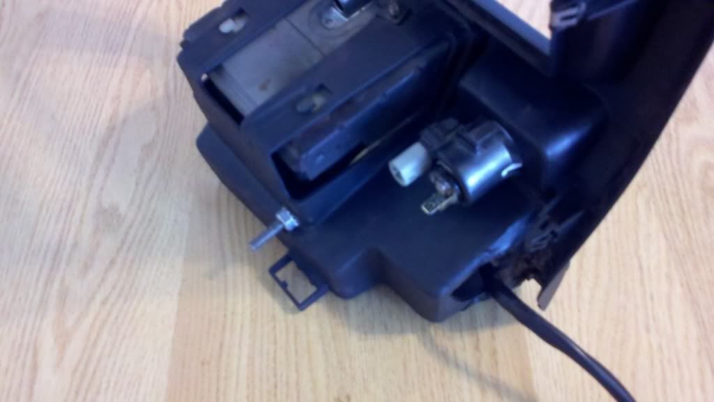

Here is a side view.
Inclinometer3.jpg~original
Back view.
Inclinometer4.jpg~original

Anyway. It looks OK. The Lights on it work like there supposed too. The is a Background light that lights up the display when the dash lights turn on and there is a 4X4 light lights up bright and then automatically dims when the dash lights turn on.
The ground and the dash lights can be spliced with the wires at the cigarette lighter and a single wire that can tap off the 4X4 light in the dash board or the 4x4 relays behind the passenger side kick panel.
Anyway - The downsides. You loose the ashtray and the little cubby below the ashtray.

Is the "4wd" light going to be functional?
And if not, am I right in assuming the only thing you need electrical power for is the backlight?
The 4wd light does function. When it is activated, the tires and the 4wd light up. When you turn on the Dash lights, if the 4wd light is on, it dims - so it is not so bright at night time.
You can get electrical power and ground for the inclinometer from the cigarette lighter backlight.
You would still need to tap a 4x4 power line from either the dashboard or the 4x4 relay under the passenger kick panel.
