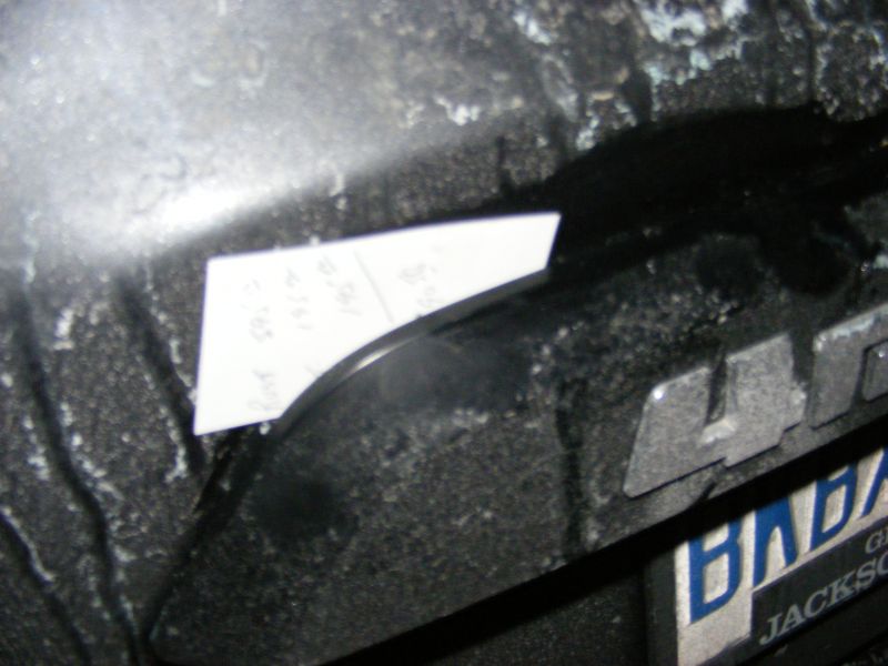

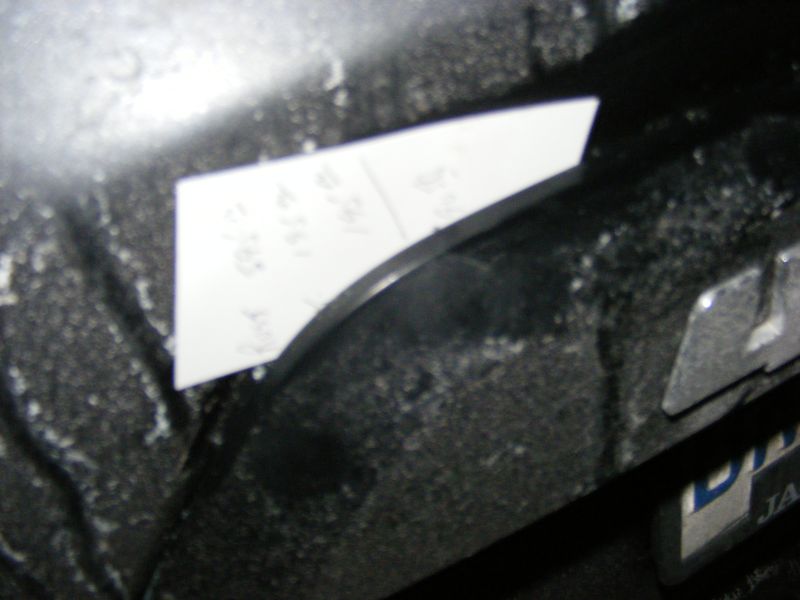

Well I finally got my 4 Runner repaired after an accident with the trailer - they had to replace the whole rear gate - everything looks great except I noticed last weekend when I was washing it - there is a gap between the plastic and the metal – the black part where the Toyota symbol and 4 runner name is – just wondering if that is normal – I did not notice this before the truck was "fixed" - can someone check there's and let me know if there is a rubber gasket or something in this area?
I could actually see daylight when I look into the gap - so both the top and bottom are not tight to the metal.
I live in Canada - so I am worried about road salt and water getting in there and rusting the gate out.
Here is a pic - I stuck a business card in the space.
thanks for your help

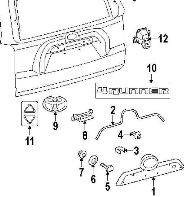

Though mine is a Limited, a card will go in maybe 1/8" before it hits a gasket called "handle panel seal" number 2

As pointed out there is a black gasket that goes in there.... I had a 'mishap' and have to replace that entire 4R chrome 'structure' on mine (no damage to the tailgate though). My local body shop had a very hard time getting the top part (Toyota symbol) to clip into place, actually gave it back to me with a lot bigger gap than yours! One of 3 things:
1) They did not realize they missed a part and it was an honest mistake
2) They had a hard time getting to to 'click' into place so they removed the gasket to give them the extra room so it could snap.
3) They realized after they installed it they forgot a piece and hoped you would not notice
I ended up removing the rear gate panel, disassembling their work and fixing it myself. It a real PIA to get that top piece to secure where it should (as they could not seem to do). There is just a little white plastic insert on the back of the Toyota symbol that has to extend into the gate and 'snap' into place. I had to apply a LOT of force to get it to secure!
I have photos of everything...but on my home computer. Best of luck!

My Limited is definitely sealed across the top... per the diagram

Sounds fishy to me too, so I just went down to my garage and checked mine - with a flashlight and business card.
Your dealer is full of it! There in NO gap on mine, and I couldn't even force the corner of a card under it. Drainage, my azz! What a load!

Well I went in last night to the dealership and surprise surprise - the business card would not fit into the new 4 runner they had there - he seemed shocked saying "it fit yesterday"....sure it did.
So we looked at my vehicle - he did agree it was a big gap and he said they could try to tighten it up - but when the weather is warmer - since the plastic might break in the cold (it was -10 out).
He still claimed it was for drainage...what a guy - I said I want it fixed like the new one - please put the gasket in.

I actually looked at mine yesterday and I have a gap on mine on both sides and its never been wrecked I could probably fit 2 maybe 3 business cards in mine.
