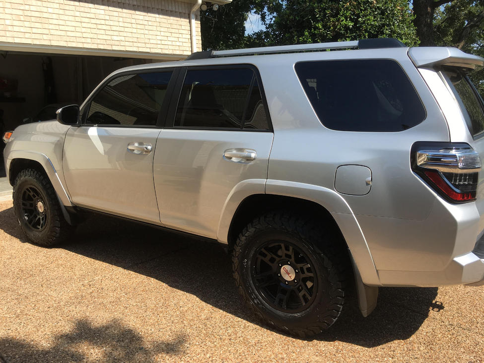

Opinions wanted: Recently had the FN pros installed (w/ BFG 265s) and the silver TRD centers. Several of my friends (and my wife) think I should go for the black centers. What say you?
