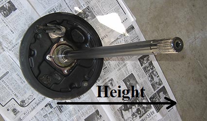

Does anybody know the length of the rear axle shaft running from the 3rd member to wheel? I am planning to buy a press and I find 35 inches for 12 TON and 39 inches for 20 TON.
Which one will you pick?

Got a couple in the basement, what exactly do you want me to measure to, where it bolts to the axle housing, the bearing, the??
From the end where the splines are to the flange that bolts to the axle housing, 26 1/4", another half inch to the bearing. To the wheel studs approx 30-31", there's a brake drum in the way, making accuracy a little harder. That one's out of an earlier 3rd gen.
