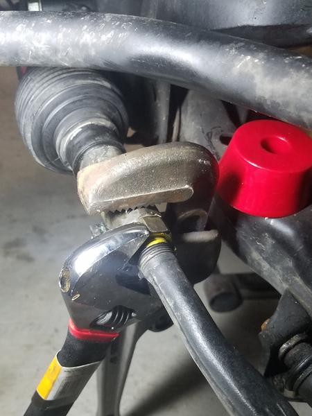

Then break the lock nut on the OTR. I used a pipe wrench to hold backup.
btot588-albums-inner-outer+tie+rod++lbj+replacement-picture49886-losen-otr-lock-nut.jpg

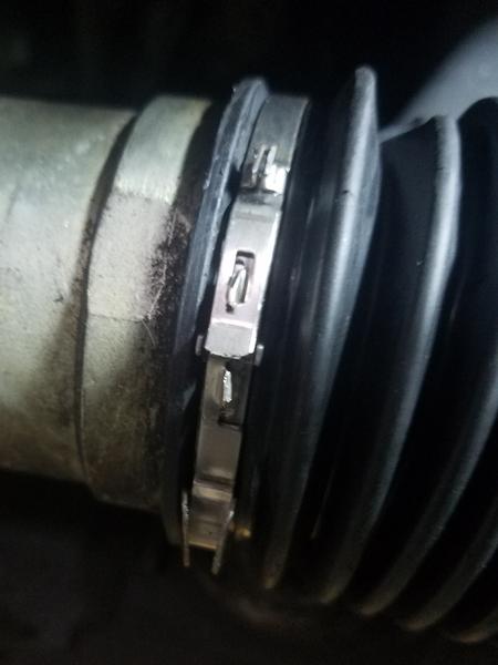

If you haven't removed the clamps on the dust cover do that now. I found it easiest to pinch the tabs with pliers and use a flathead screwdriver to pry up the metal lock. I didnt damage it but had a new one any way.
btot588-albums-inner-outer+tie+rod++lbj+replacement-picture49882-installed-itr-clamp.jpg

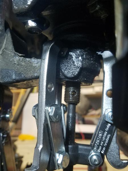

I wanted to remove the ITR and OTR before I removed my LBJ. I used a 3 arm puller to pop the OTR out. I compressed them until I felt they were putting sufficient pressure, then used a hammer to shock it into releasing. Watch your hands!
btot588-albums-inner-outer+tie+rod++lbj+replacement-picture49874-3-arm-puller-otr.jpg

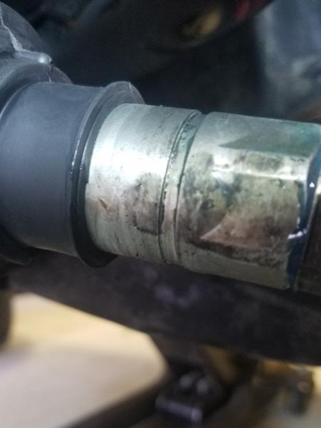

Then I marked the OTR where the lock nut to help with installation. See the yellow paint? Count your turns on removal, mine was 19 on passenger side and 18 on drivers side.

Now that the tie rods are out of the way I used the 3 arm puller to pop the LBJ out.

After you have hammered in the washer to the flats on the ITR you can install the dust cover. The dust cover goes to this groove on the ITR. Meaning the front of the cover will just hide the groove. Please put the clamp on before you install your OTR or you will have to take it apart again. Ask me how I know. :)
btot588-albums-inner-outer+tie+rod++lbj+replacement-picture49877-band-itr-where-boot-goes.jpg
