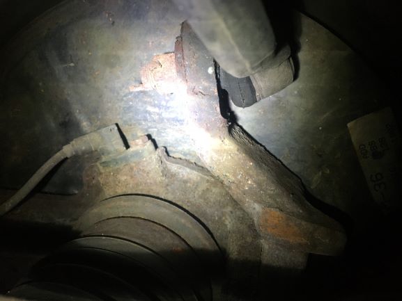

Could anyone give me there opinion on if this looks damaged or in need of urgent replacement? I'm mostly concerned about the angle where it connects to the LBJ.
I'll be doing the from suspension, so figured I could do lower ball joints and outer tie rods while i'm in there (I think they're both stock).
The angle not a problem, you can straighten it with a pair of pliers on the shaft.
Tie rod end is just rotated. You can turn it back to flat with your hands or pliers.
