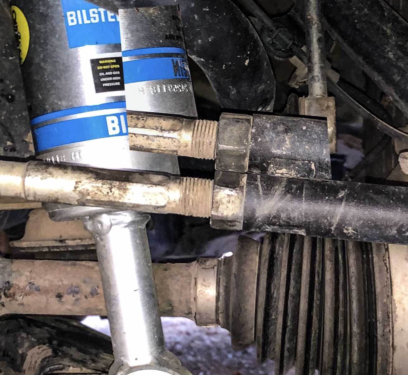

Here is a photo of the tie rods, the main photo is the driver's side, and I've added the passenger side on top (mirrored for comparison), you can see the
driver's side has more exposed threads. Could this be causing the issue?
Very well could be, looks like two more threads showing on one than the other.
I'm not "qualified" either, but putting on the SPC adjustable UCA's causes one to try and get smart on it or you could waste a lot of $$ on alignment shops that know just a little more than you do, but don't really care.

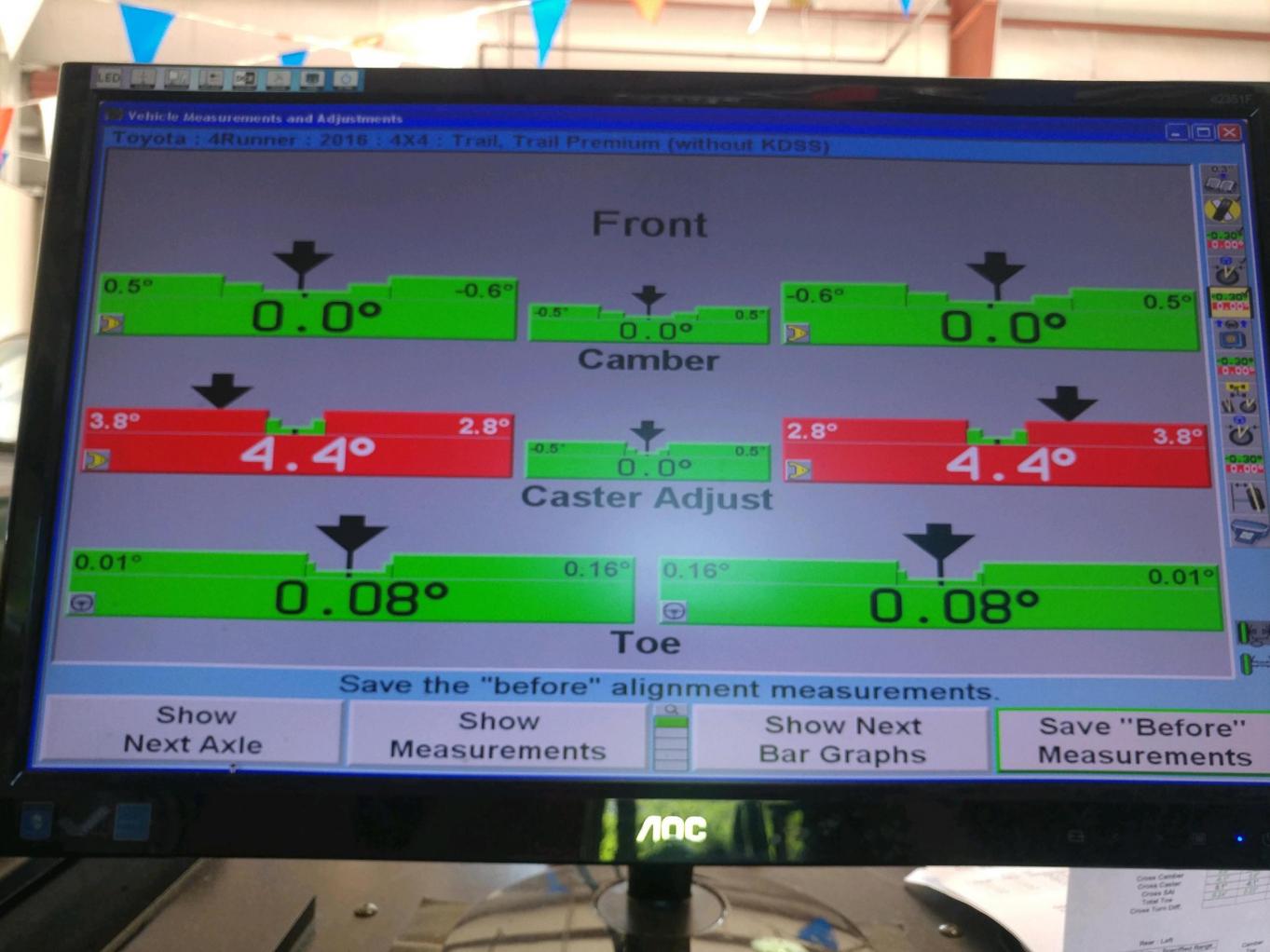

Here is mine with JBA's and Kings
