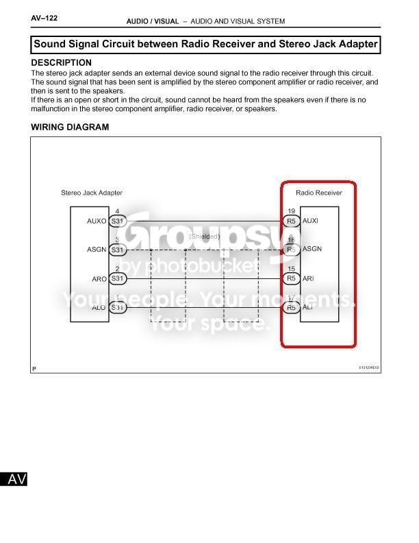

There is no RCA plug, you will have to tap in to the 20 pin connector that is also used for the steering wheel controls. This plug and its ribbon cable were there from the factory in my 2004 non JBL system which didn't have steering wheel controls.
05300341copyred.jpg~original
If you want Aux in the factory location, you may also need the jack and cable that run to the inside of the center console. I can probably sell you mine for a few bux + shipping, as I no longer use it.

Yeah, thats what I did. I grabbed from a wrecked scion the aux port along with the cable that goes from the arm rest console to the radio. Its a little smaller then the holes in the center console of the 4runner, like where the dac is. So I took out one of the filler blank ones, and cut a piece off and glued it cleanly to the aux port. I then installed it in my center console, and now I use it for pandora radio from my ipod.
