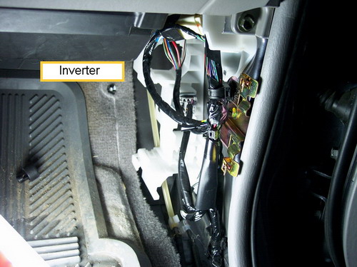

I want to install this unit on passenger side under the glove compartment with Velcro and wire maybe to 12v plug with in line fuse. Any other suggestions????

This is location where i want to install inverter.
Atomic what do you think about this location?

Hm....Looks fine to me, but I guess it's all up to you, where YOU want it. Laptop use only still? Have someone over 6 feet sit there and look for a place to put it. That would be my best guess.
