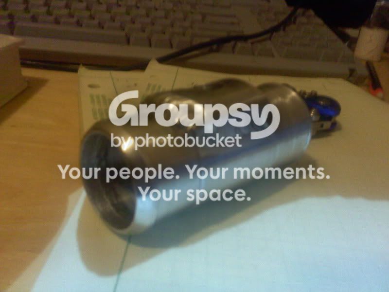

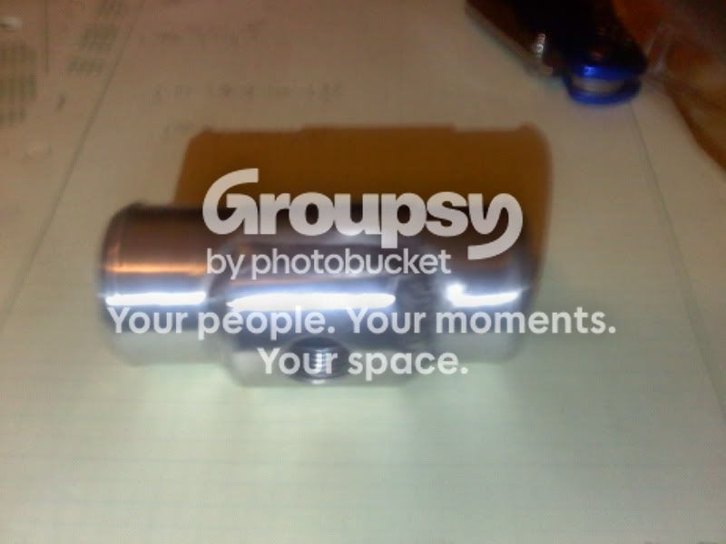

So i think i figured this out and it will be installed this weekend i hope. I bought this controller
Derale 16749 Derale Electric Fan Accessories
and then made my own rad hose adapter because couldn't find the right diameter adapter with a 3/8ntp
Heres are the pics of it, sorry crappy cell pics. hopefully it gets the job done.

Just an update on this. its working fantastic, ambient temp does not really play a roll with this one. have no had to worry about the fan coming on and it turns off quickly as well.
