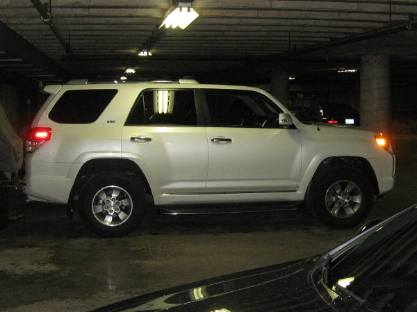

so in theory the set of bilsteins would be the way to go. Match the front and rear in stiffness. If you set the fronts to 3rd notch of 1.75 and the rears raise .5 then would level nicely and have a tiny bit of rake. plus the rears would be stiffer - if you added passengers or loaded would not make front end higher.
everyone's thoughts? i'm debating on 3rd notch as opposed to 2nd notch. i want the front leveled. too low now.

...... everyone's thoughts? i'm debating on 3rd notch as opposed to 2nd notch. i want the front leveled. too low now.
Here's mine w/ 4 X 5100's, front set at second ring (.85). Sure looks level to me.
