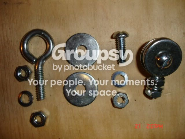

When tuning an open exhaust on harleys sometimes I've installed a 'lollipop' to help tune backpressure. It's a washer that fits in the opening 2x the pipes diameter in, and welded to a bolt than can be tightened when the reversion/backpressure has been corrected. (by rotating the washer inside the pipe to allow/block exhaust flow). If the exhaust is flowing too much, opening the intake will help, but it's a balancing act, too much on either end causes problems.

Just one way of doing it.
That is a very good idea. If patching the leak does not solve the problem I might do something like this. I was thinking about an intake but I like the stock intake as the filter is protected in the box from water/mud etc.
