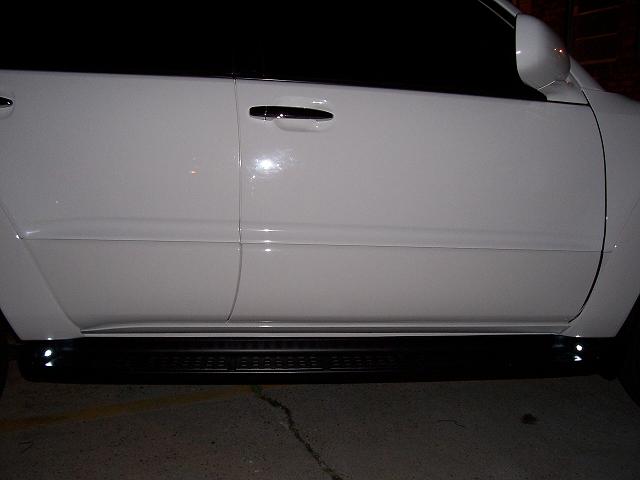

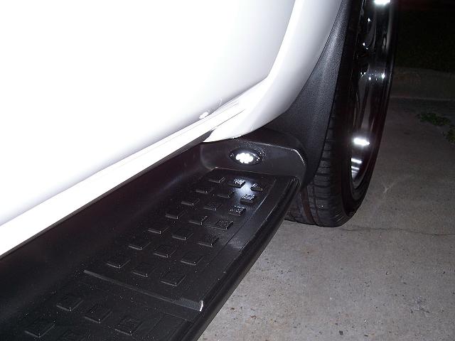

I got the idea from this forum (LV4R). They are from superbrightleds.com. The pics don't give any justice of what it looks like at night. It lights up the running boards, curb, and some of the 4runner. I have the white leds, but they do have a slight blue tint to them. This is really a install well worth $60 dollars and a 1/2 days time to install.

Was going to get some LED lights for interior illumination, had not thought of LEDs for the running boards. Maybe a pic while it's dark would should the illumination better than pic #2?
I took the pics at night, but i guess I need to find out how to take the flash of the digital camera. I will try new pics soon.

You're right -- the flash is definitely preventing the pics from showing the results of your work. I looked under the running boards tonight, and cutting the hole in each end cap is probably the hardest part of the job.
No cutting a hole, the led light mounts with 2 screws. You do need to drill a hole in the center to pass the wires.

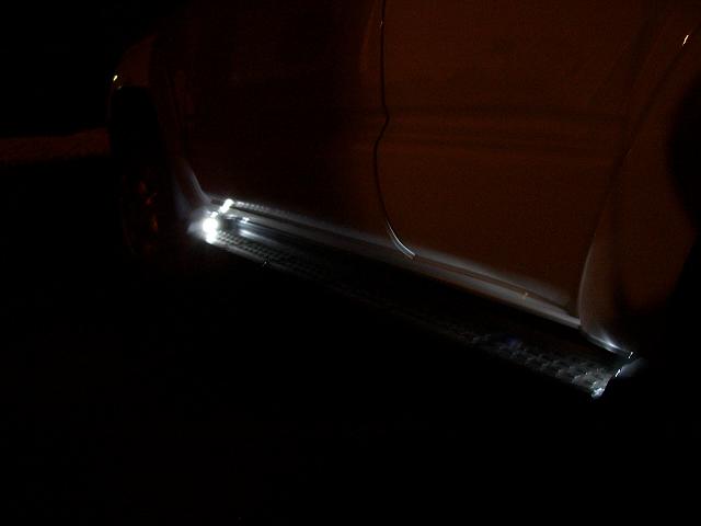

I will take a new pic tonight with the flash off.

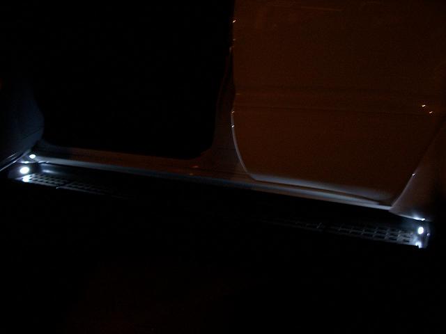

I tried a couple of quick pics with the flash off. It gives a better idear of how it will look, but to me it does no justice for what it looks like it person at night. It has rained a few times since the install and I wash it every weekend, so far so good.

Thanks for posting. Sounds like you're saying that the two LEDs light up the entire running board and that rain doesn't cause them to be useless.
