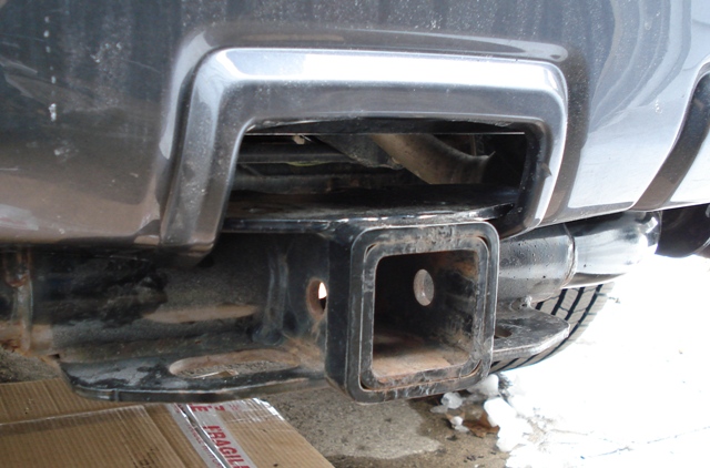

I installed a used OEM hitch on my '08 T4R SR5, V6 and I had a few questions:

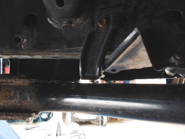

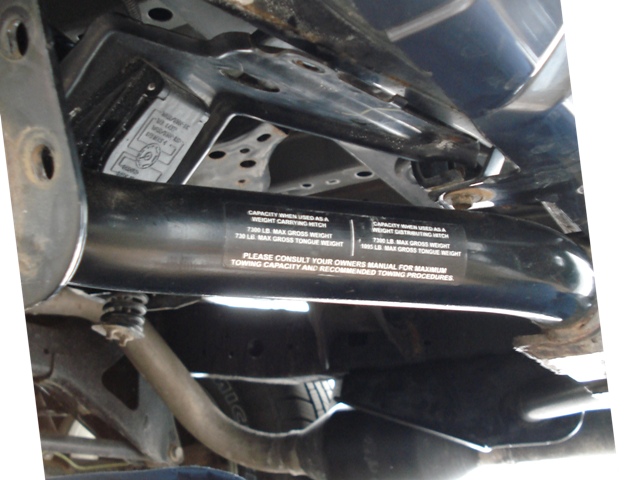

It doesn't seem to sit in the cutout in the rear bumper correctly. I thought it's be more "snug" in the hole? Also it is a 7300 lb hitch and I think being as I have the V6 I should have the 5000 lb hitch. (I didn't kow there was a difference when I bought it used). Also the 7 Pin out connector will not fit where it was before I put the hitch on. I had to take it off the bracket and cable tie it to the htich until I can figure something out. I need to tow a car via a tow dolly this weekend and I hope this install is ok. P/N on the hitch is PT228-89440-14628-09004
See the pics for further explanation. Pic 1 shows how it doesn't look correct, Pic 2 shows the bracket not fitting where it should and Pic 3 shows how the hitch pushes against the bottom of the bumper cover.

i don't think thats a 4th gen OEM hitch. mine doesn't look like that. its just the end piece directly bolted to the frame
my 08 v8 hitch fits snuggly in the cut out. it's raining it's arse off here or i would go and have a look for you. in the second picture it looks like there are two bolt holes that once connected to something. i know it sounds stupid, and i almost hate to say this, but is there another set of holes in the frame rails for this to mount to?
There should be a sheet metal piece that covers that gap between the bumper and hitch. I don't recall if the GX470 hitch has that metal piece.
The V8's weight distributing hitch receiver sits slightly lower than the V6's weight carrying hitch. The included drawbar from Toyota will tell you to flip it for the V8 so it's orientation is an upside down "L" and on the V6 it'll be mounted as [hitch]==L.
You most likely have a V6 and the weight carrying hitch which only attaches to the rear cross member. The V8 weight distributing hitch attaches to the frame rails and rear cross member.
The two holes on the side of the hitch should be where the 7-pin trailer electrical connector attaches too. On the V6, it's attached on the rear most cross member, where the OP shows his mounted loosely in the second pic.

Looks like the right hitch. Did the bolt pattern line up OK?
The only thing I notice is the bumper cover is pulled over the top plate on your hitch. Shouldn't the bumper be sitting on top of the hitch like Uneek's 1st picture?
Yea, the bolt holes lined right up perfectly. Wasn't hard to install at all, there's just the issue of the gap in the center and where to mount the 7-pin connector. PLUS I hope there isn't suppose to be additional mounting at the center part of the hitch, where the receiver is.
mine is like yours but the one he has is oem. some werent directly on the frame
I am (slowly) learning the V6 hitches were just attached to the end of the frame and the v8 hitches (like I installed) were frame mounted on each side of the frame. Since I have an OEM Toyota hitch from the V8's hopefully it's on OK and that's just a cosmetic piece between the hitch receiver and rear fascia/

From what I recall, that's how the 7-pin connector is attached. I think the bracket might be different from the V6's.
