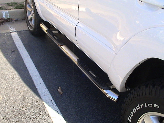

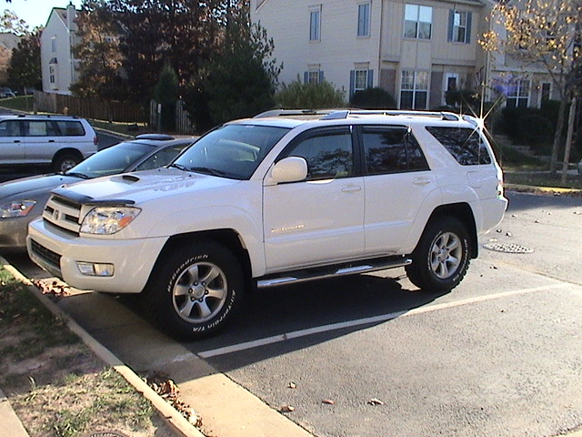

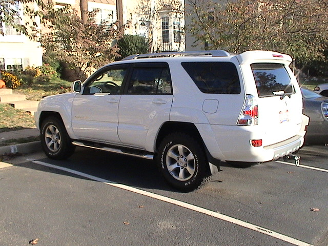

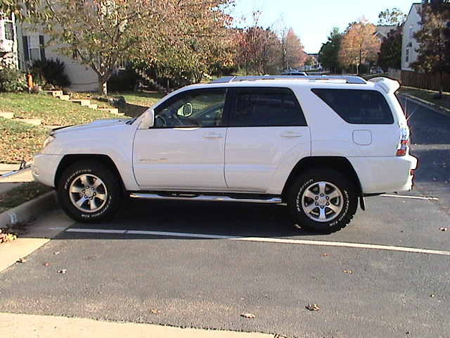

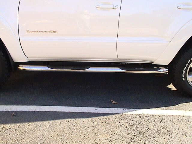

Here are a few.. I think it looks fantastic, I got em for $125 shipped from ebay

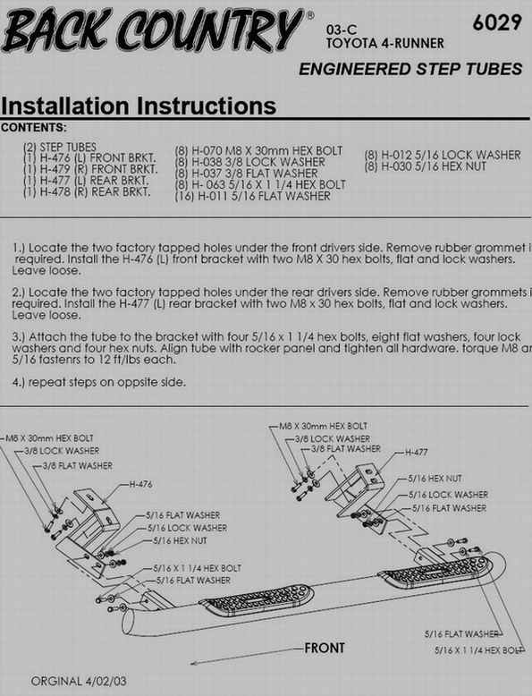

The install was just about as simple a thing to do as there is, about 30 minutes maybe...
All I needed was socket wrench...
I have a copy of the install instructions, if you want to see them...
