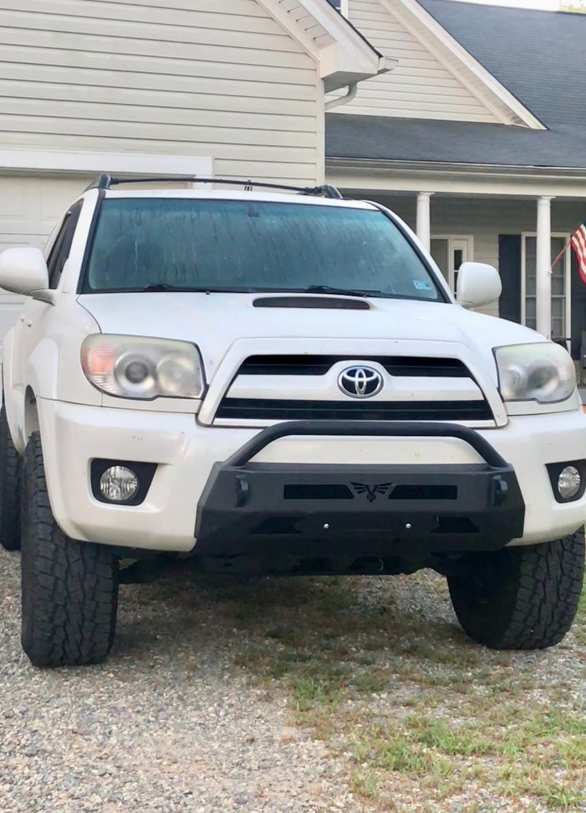

I recently installed their blitz winch mount bumper with tube, gives the 4Runner a nice clean and fresh look. Have yet to test it out as I don’t have a winch, light bar or shackles. Fit and finish are excellent, they do an outstanding job.

Let's see that new bumper of yours!

I’m happy with the the looks and design of the half bumper while retaining some factory aesthetics.

The design is reminescent of the fat lip 99-02 4Runner bumper. At least to me thats what it does. I'm not a big fan of the phoenix. I would rather just have like a sticker I can put off set to the side or something...
