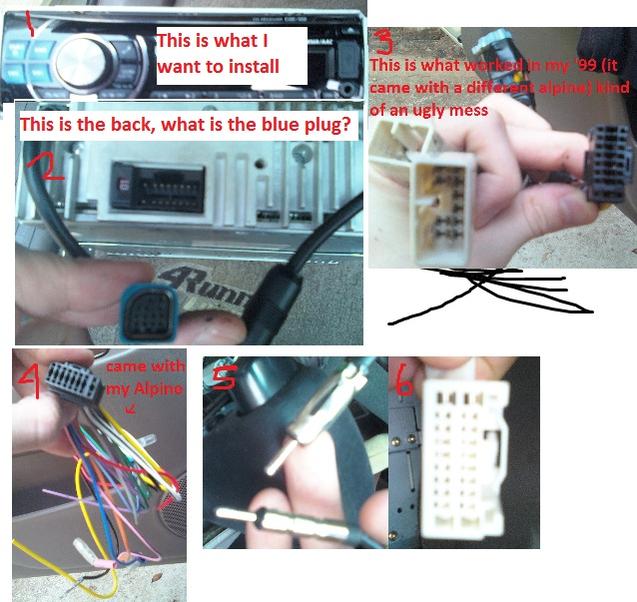

I made up this picture of everything that I'm working with. Now I hadn't needed to do anything technical when I upgraded the first time, but now the cord connecting to this stock system doesn't plug into what I have.
(I'm not very knowledgeable about car stereos and wires so if you'd care to explain the pieces it would be nice to learn some)
So pic 1 is the head unit I want to install.
pic 2 is what plugs it has on the back. (What is the blue plug for?)
pic 3 is the black plug that plugs into the back of my Alpine unit and the bigger piece had connected to the car in the old 4runner.
pic 4 is the plug that came with the new head unit, though i never had to use it.
pic 5 is the antennae I believe but what is the other one for?
pic 6 is what plugs into the back of the current stock system from the car, but not into this Alpine unit.
So what do I need to do/get to get this unit plugged in without paying for an install? Thanks

the blue plug on the apline is probably for a cd changer or something wont need it now the antenna's the big one goes to the radio the little one dont worry about it is just for the antenna in the back side window and pic #6 thats the plug for the amp you dont want that one theres 2 plugs that go into that amp those are what you wanna connect to the harness in pic #3
look for these two plugs its gonna be plugged into the factory amp
Thanks, what a simple thing, I got all the wires plugged in right and than I attached the unit to a little black drawer type piece and mounted them in, but now when i try to put the panel back on that covers the front it will not lock into place. The problem is with the middle clip that goes in right next the stereo. I'm currently working on it so if anyone has tips on how to lock that piece back in it would really help.
^^^ Yep.
I had the same problem when I went to put my new hu in. There are two plugs going to the bottom side of the amp that you want to use. They are almost impossible to unhook without taking the screws out that hold the amp in place.
Well i got it all back in place, just barely, i don't have quite enough room to put that black rim piece that goes around the unit but I am satisfied.
