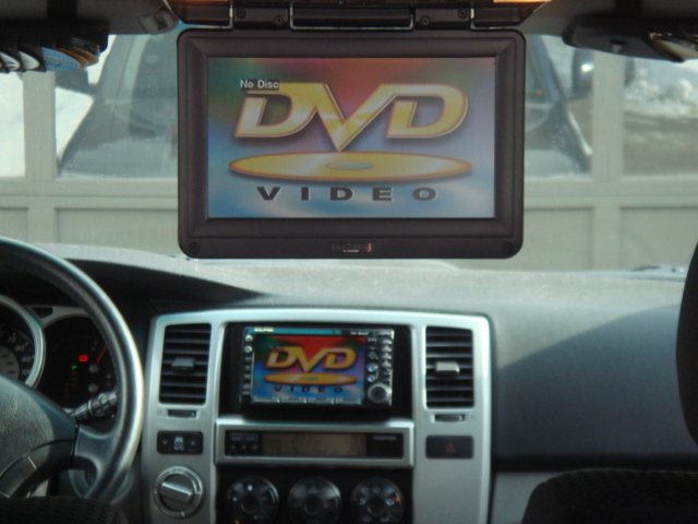

I installed a overhead monitor without removing the headliner. I ran all the wires on the pass. side then up the B piller to the dome light. I did remove all the trim on the pass. side. I removed the dome light and mounted the new monitor/dvd player w/dome lights. There is enough room under the headliner for all the cables. You just have to make sure the wires do not interfere with the sunroof headliner panel. The dome light is mounted to a double walled piece of steel. I was able to just line up the new monitor with the old dome light and screw it to the bracket. Any other installation question let me know. ERIK
