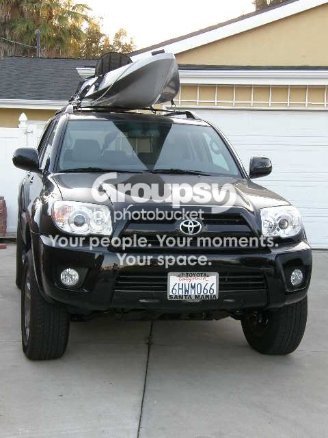

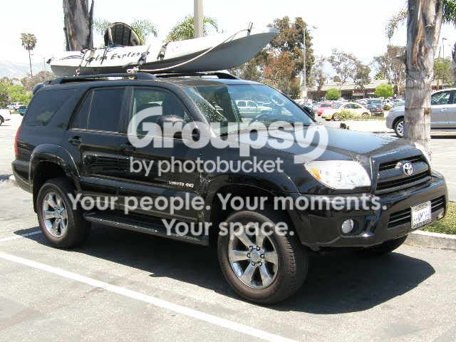

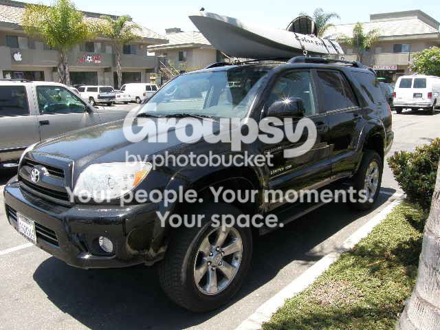

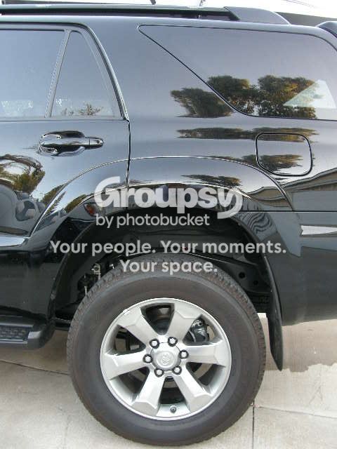

Strapped to the desk - but took these shots today and will get better later this week. Needs a wash to get the sand out and still looks like a grocery-getter to me but better then Friday! Need wheels so I can get tires. This raises the big question that no one is yet to answer - how will 17x9 inch wheels fit under there? Anyone running them and are you having any problems?

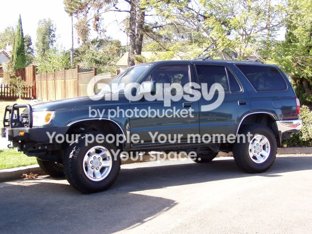

And one more for old times sake.... my 96 4x4, Downey coilovers, ARB, Warn Winch & Lights, PIAA lights, Air-Lift, aftermarket leather, In dash DVD and 285000 plus miles of pure off-road abuse in the Eastern Sierra's before being semi-retired in Vermont as a hunting rig:
