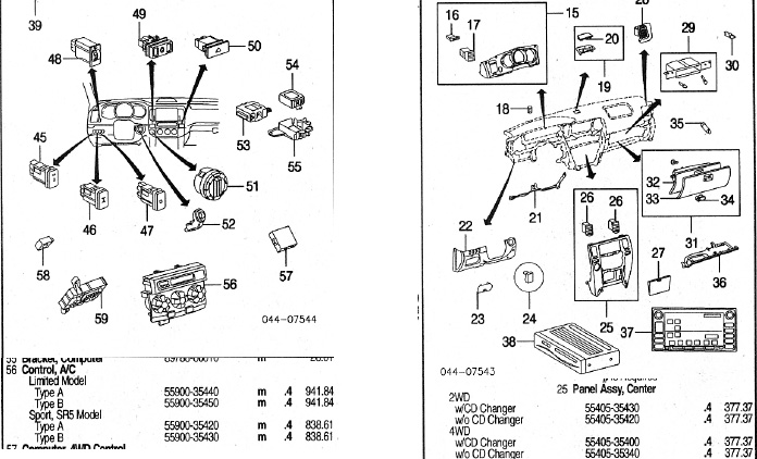

I'm installing the AVN 5435 (double din unit). I have the JBL 6 cd changer. I want to purchase the dash parts to make the unit look stock. This thread points out which parts to buy. http://toyota-4runner.org/showthread.php?s=&threadid=9821&perpage=15&pagenumber=1
It shows i need to buy the ac control unit and the center assy. Does anyone know what the difference is on the ac control unit? There is a "type a" and a "type b".
one has a small little plastic piece/bezel that goes under your cd changer, the other one is a little narrower, for single disc and navigation.
