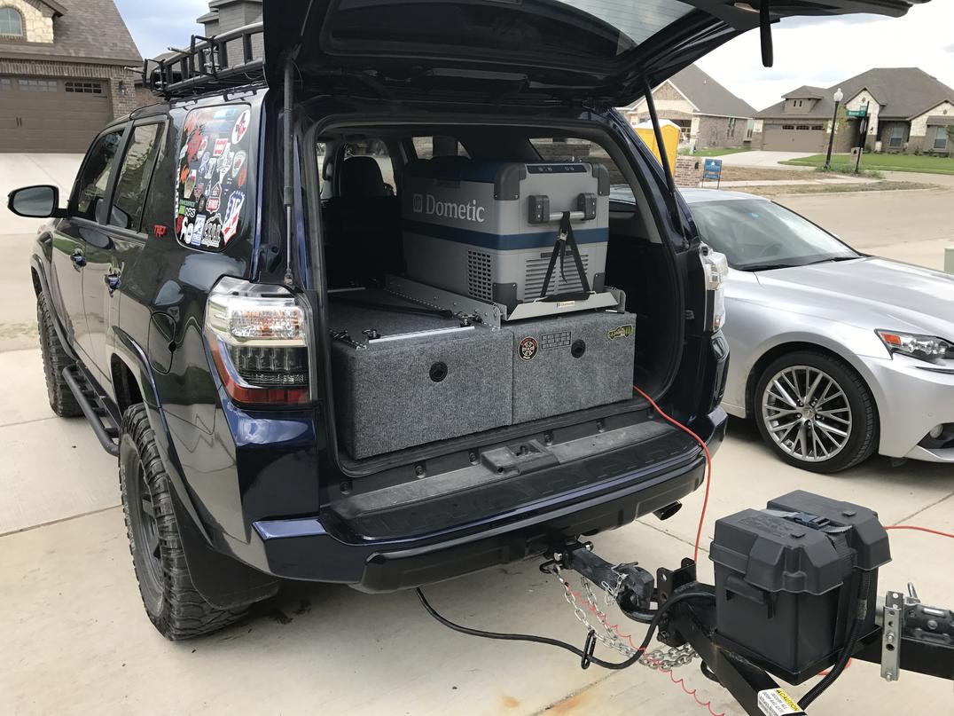

What's funny is I noticed the same exact thing this weekend when I finally mounted my box, slide, and fridge in for the first time. What I did was use both plugs in the back of the fridge and then when I was at home or in camp, plug the fridge into the a 110 and then when traveling, let the 12v run. When the battery was plugged into the 110, the truck still did not want to unlock. I had to get right up to it or press the button a ton. I did use the spare key as well as changed a battery and still the same result. I am not an electrician by any means so before anyone blasts my method, please understand this was a temporary set up to show the fiancé that it was a great idea to get a fridge. (After she had cold watermelon Saturday evening in the heat of the day, I got the "nod of approval."
I am interested as to see what others say. Here is my set up.

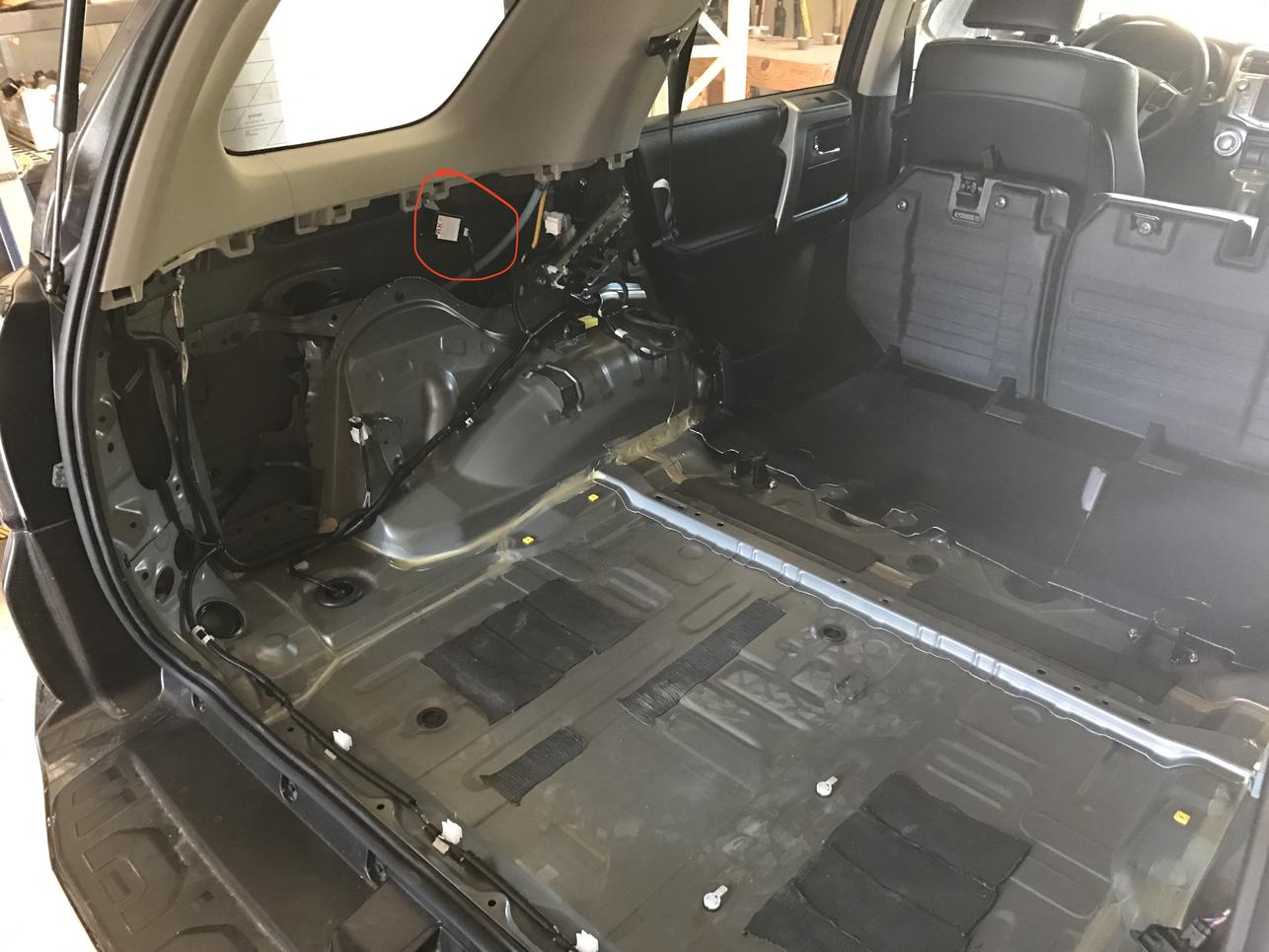

Based on this, that sounds like the fridge itself must be creating interference with the remote sensor. When I took the side panels off the cargo area of my 2016 SR5, I noticed that one of the sensors is mounted above the left wheel well (I'm not sure if its the only one) See picture below

I will definitely look at moving the receiver next time I can get in the panel.
Thanks for the picture [MENTION=150728]jakerunner[/MENTION].

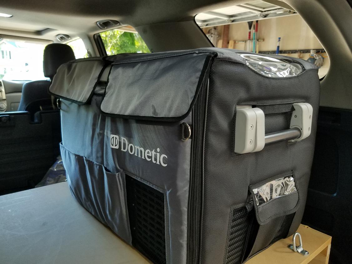

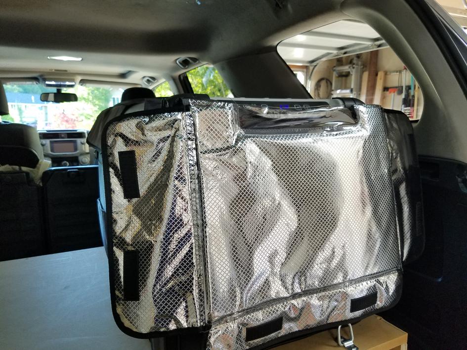

Quick update since I hate it when people don't report back.
Cover arrived and put on. Door locks work just fine again.
