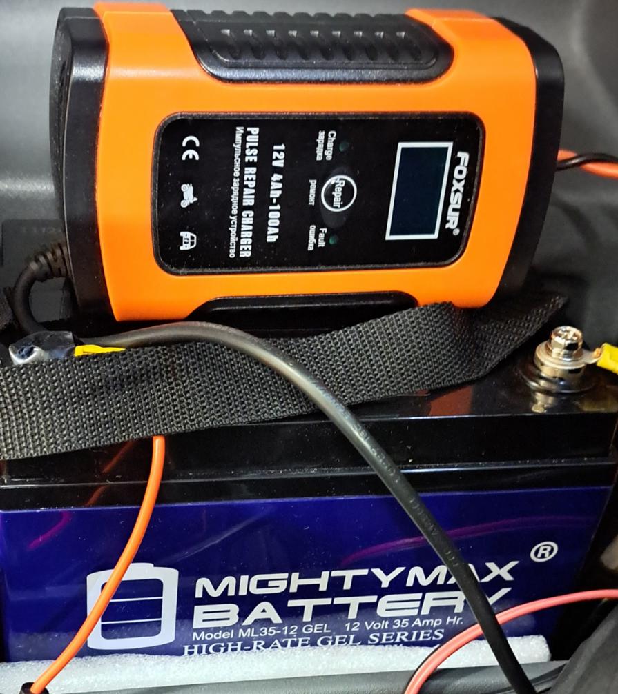

12V for Cooler
Not enough power from the 12V outlet and I did not want to run a wire from the front and did not like the $$$ of a Jackery unit.
Not as convenient as a Jackery or EcoFlow all in one unit, but less than $100 and works well.
I run the charger from the 120V outlet and it charges the battery and runs the cooler when the engine is running. With engine off, the battery continues to power the cooler. I had to use a charger that takes less than 100 watts.
In our Sienna the 120V outlet automatically turns on with the engine. In the 4Runner I have to remember to turn on the inverter.
Sometimes on a trip, I leave the cooler running overnight from the small blue battery, take in what we want and not have to carry in the cooler.
