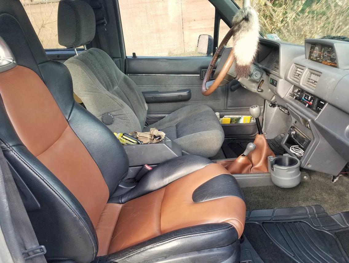

Picked these up a couple weeks ago. Have the passenger ready to bolt in and will get the driver's tomorrow. Was not that hard. I will add to the thread with details. What I'm not sure about is wiring up the heat and power (passenger is mechanical). Any help greatly appreciated.

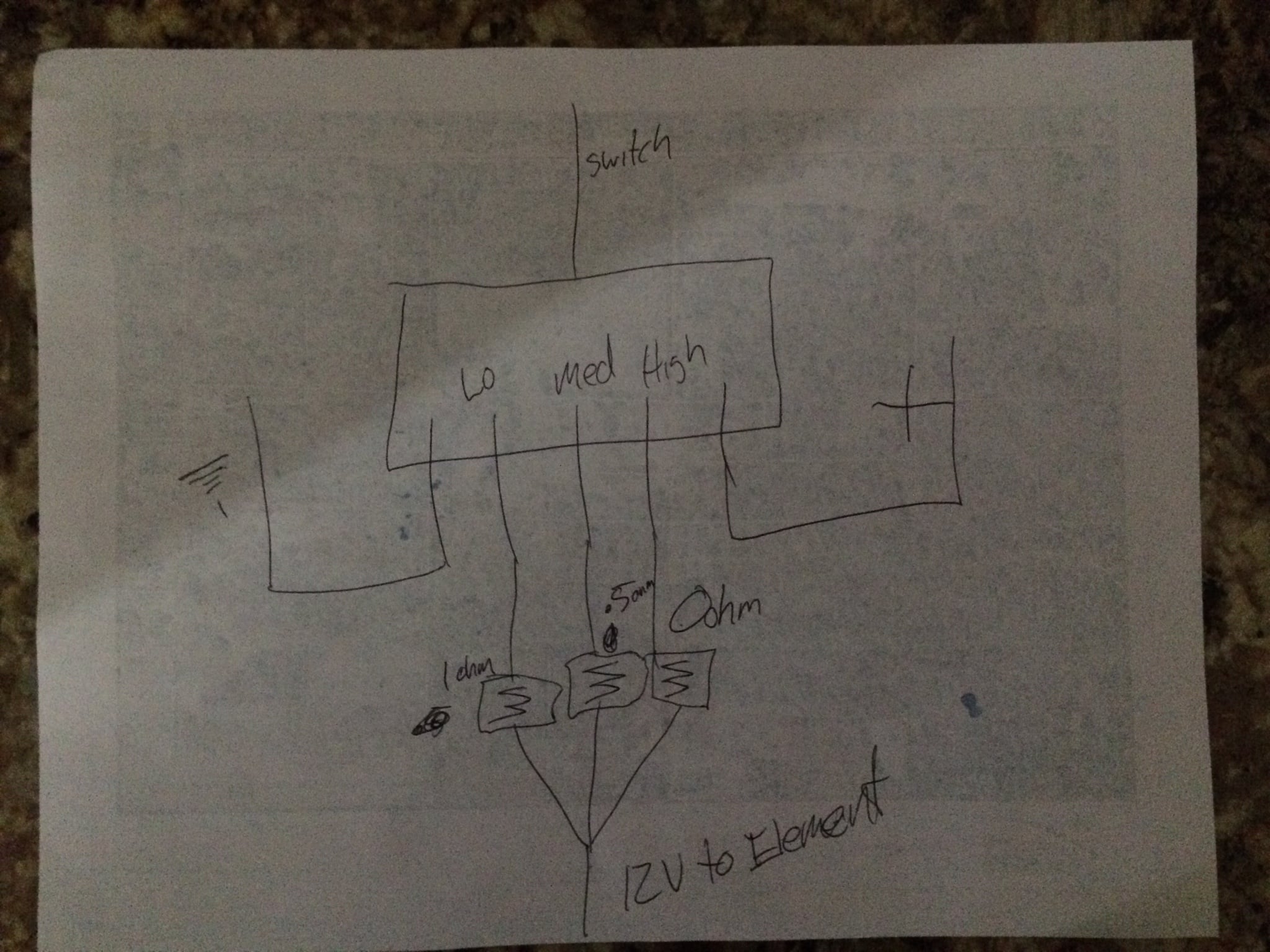

Well it all comes down to 12v and resistance so even if you don't get multiple settings you can always just try different resistors after a toggle switch until you find the right resistance to heat your buns just the right amount. Or try something like this. Then you can wire 2 different resistors for high/low operations.
Power and ground with 2 resistors should be that easy. As long as your heating element is 2-3 wires that's all it should need.

Pulled this information from the forum I was a part of back in the day
http://www.rx7club.com/2nd-generati...how-wire-up-leather-powered-rx8-seats-992255/
According to him you only need the 12 V blue wire which I'm assuming the ground is somewhere grounded to the chassis. Or seat frame.
So you just need a multi position switch with different resistors after the switch on multiple wires. Leading to the positive feed.
It should look like this. But don't take my resistor numbers you will have to research the max of your element and test the values below that for the right temperature outputs
I have been following this because I have heated seats from a Volvo that I talk about wiring up, but never have. Mostly because the heater works pretty good, and it doesn't get that cold here.
In theory you could run 12v straight to the 0 ohm wire and cycle the seat on and off as it got too hot. Right? The 1 ohm and .5 ohm would be low and medium settings?
Will this pull enough juice I should run a relay and pull from the battery?
So do those seats have you sitting higher or lower than stock?
Actually very very close to stock. I cut the old brackets off, removed the ones from the new seats (bolts, etc) and then welded the old brackets to the new rails. I think I might be sitting a half an inch higher but that's probably because these seats aren't 30 years old....
I'm working on figuring this out now. I won't have answers on the wiring for the heat until I have the switches that purchased on eBay over the weekend. I bought some from a Mazda (same ones that controls the seats). They are rectangular and will fit right in the empt slots above the stereo.
