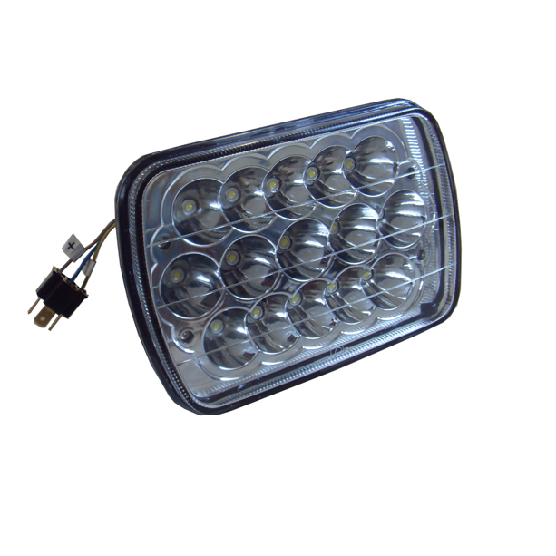

hey guys, i just got a set of the truck lite 5x7 led head lights and was wondering if anyone has put them in their 1990 4runner yet? trying to figure out the best way to do it or how difficult its going to be and how much, if any of the front grill needs to be dissassembled?
thanks in advance and sorry if theres already a topic on this and i didn't see it. if so, please shoot me a link. id love to get a little step by step on it.

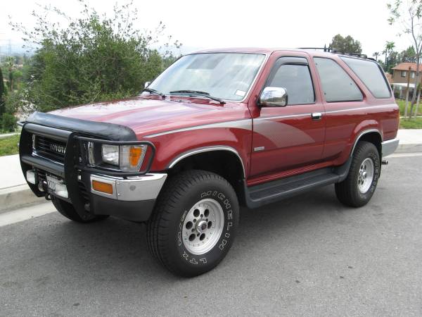

Where'd you get that bumper??
first you will have to take off your bumper/grill guard. (there isnt enough room to pull out the grill with it on there)

no way, seriously? that grill guard isn't really connected to anything other than underneath and and the very outside of the chrome corner bumpers for stability.

have the same issue on my first gen with Smittybilt bumper
& yes I had a second gen as well.... had a push bar/gril guard on it (but I left it off when I had the grill off)

thanks, i didn't think the grill guard would be an issue. its not touching any part of the grill. and i saw the clips on the top edge of the grill pieces, but i wasnt sure if those are the sole pieces that disconnect everything or if theres a bunch of screw/bolts not visible?
there are just as many across the bottom of the grill (maybe 1 less) was back in july when I had my second gen apart.
you could try to get the grill off without removing the guard.... (mine had roughly 1" & that just wasnt enough room to get the grill off without damaging anything)

Do the removal once, install a good unit in place of the standard H6054 sealed beams, such as the Hella housing, then drop in H4 led bulbs.
There's a TON of LED H6054 lamps, but I think they are all just friggin' ugly as hell, like these:
