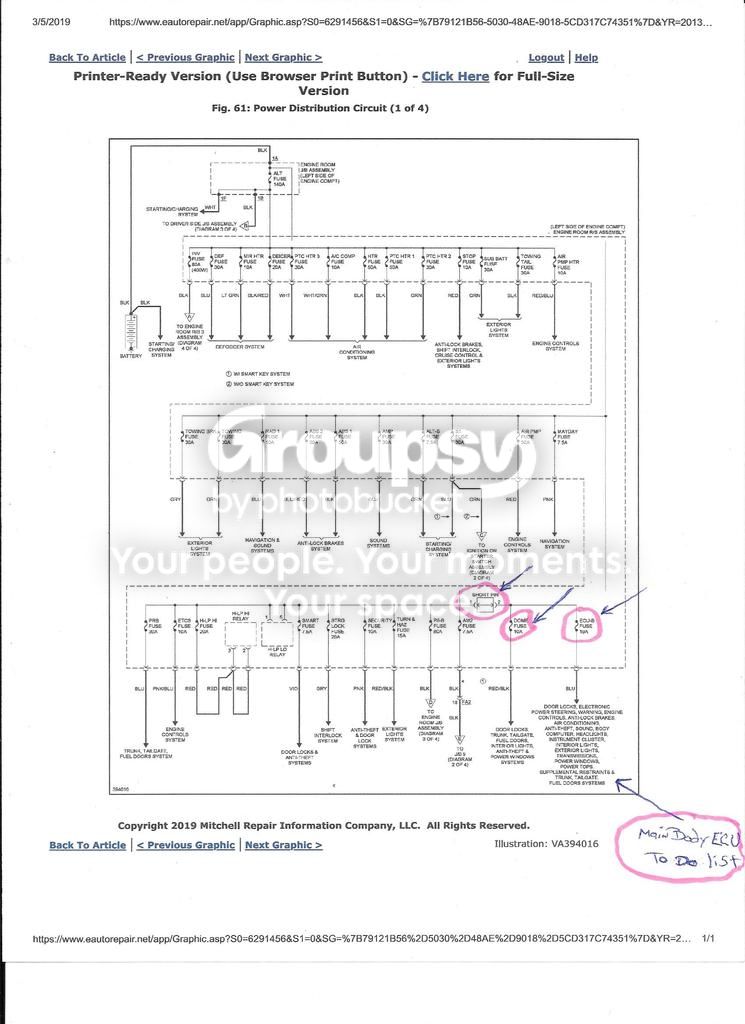

First, I'd like to go over the 'Power Distribution' schematic (below) just a lil'! Now you don't need to understand a whole lot of Advanced electrical schemes to follow along... this is structured for 'Beginners', okay(?) lol!
On the wiring distribution print below, there are four pink circles with arrows. There's the 'Short-pin', the 'Main body ECU 10A fuse', the 'Dome-light', and a list of your truck's electrical systems that the MB-ECU presides over/controls!
I'll start with the 'Short-pin' above! The short-pin, although it resembles a fuse... it's not! It's ONLY purpose is so that the electrical power that feeds ALL of the ecu's and the 'Dome light' can be disconnected while the new truck is being transported from the factory in Japan, to wherever it's going e.g., the USA, Canada, the UK...etc!
These trucks may be stored for extended periods of time, so just the dome light left on could potentially cause a problem when it ultimately reaches it's final destination; hence, the short-pin, can be pulled out BEFORE it leaves the factory; see above:

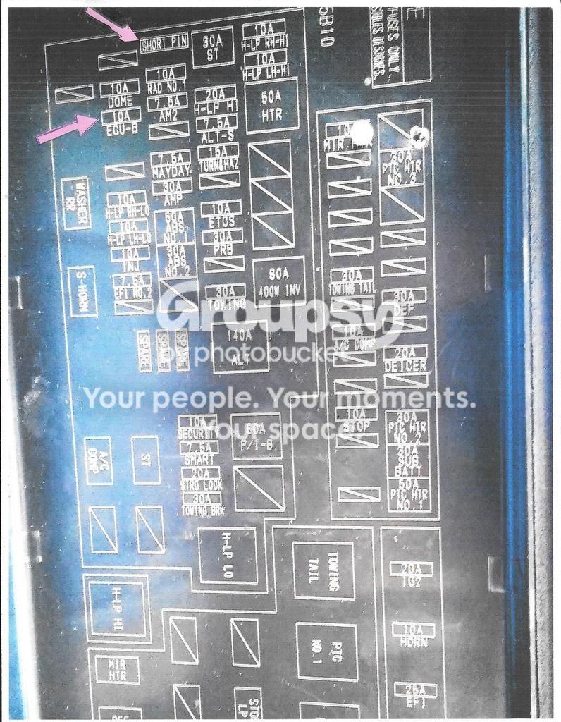

Now Below... is the 'Main Relay/fusebox directory cover'. It's there to assist you in finding a fuse or a relay at a glance when problems arise! I've got pink arrows on the photo to highlight the short-pin and the Main body ECU 10A fuse!
Pulling the short-pin will disable almost everything that you're used to working without thought, including the alarm system and the courtesy lighting system! This can also be used to do a 'MASTER RESET' when anyone of those systems listed on the power distribution diagram above is having issues.

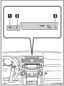

I wanted to share the "How to" wrt the "Deviation Calibration" procedure just in case you find yourself with the little DOT to the left of the Direction symbol on your compass display screen... it's really easy!
If you see a DOT beside the direction symbol e.g., .N then you need to perform a "Deviation calibration & Circle calibration".
You first need to go to a place where you can drive the truck in a circle; like around a monument or a parking lot where there are no other cars!
Pull over. Turn on the parking lights. Now, locate the "Mode Button"... it has a down facing arrow on it. Press and hold the button in for six seconds. A number from 1 to 15 will appear on screen. Locate where you live on the map below; the number is just LEFT of the line that goes through your area (in the United States), my number is #12 since I live in Jersey!
Use the "Mode Button" (#1 pictured above) to scroll through the numbers. When you're at the desired number of the state that you live in, press and hold the SET button. Your "Deviation calibration" is done! Now press and hold the mode button again; that will put you in "Circle Calibration" mode.
You should see just the letter of the (approximate) direction that you're facing. Now begin your circle. You can even circle the block you live in, as long as you complete it within two minutes! As you pass your starting point, the DOT will disappear; "Your done"! Hope this helps to simplify the procedure! 'Best',
