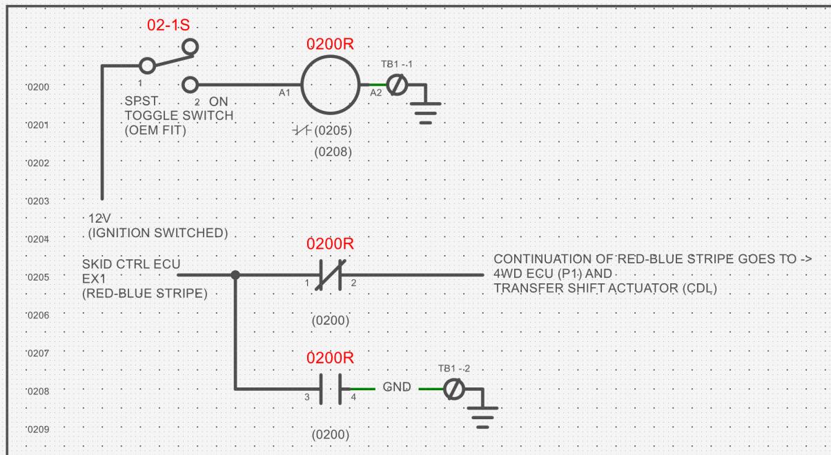

TLDR: Cut the RED-BLUE STRIPE wire from the Skid Ctrl ECU. To the ECU side connect the RED-BLUE STRIPE wire to the pole of an SPDT relay. Connect the normally open relay contact to a ground point. Connect the normally closed relay contact to the other end of the RED-BLUE STRIPE wire that was cut. Trigger the relay with a toggle switch of any kind. Get 12v from a source that turns off with the ignition.

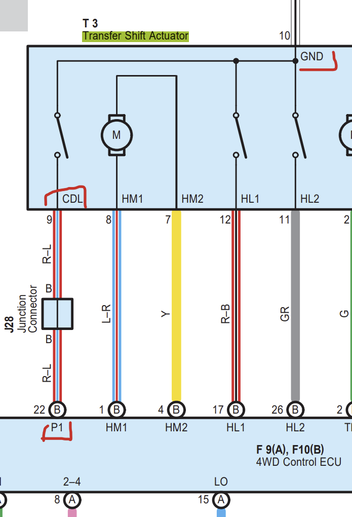

Here we see the interconnection between the center diff lock sensor and the 4WD ECU. When the center diff is locked the CDL output is connected to ground.

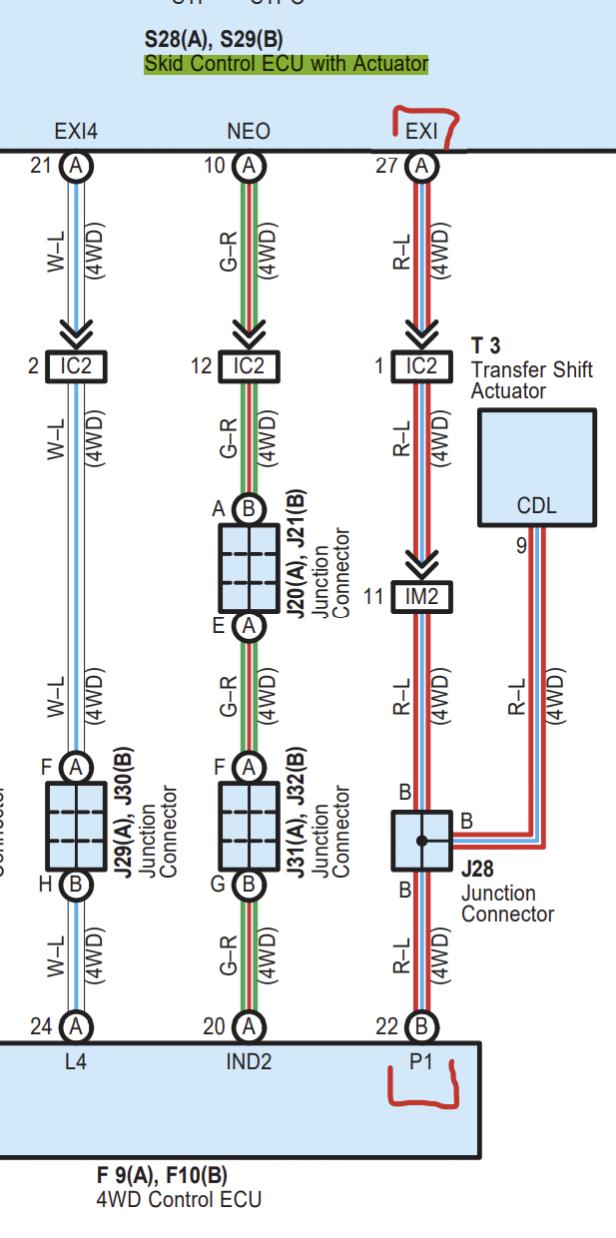

Here we see the connection between the Skid Control ECU the 4WD ECU and the center diff lock sensor. You can see the split between the three ECUs at J28.

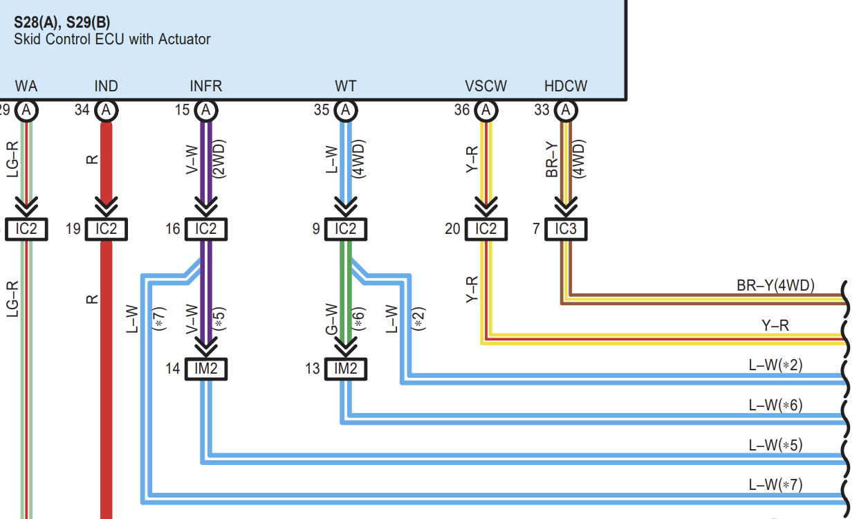

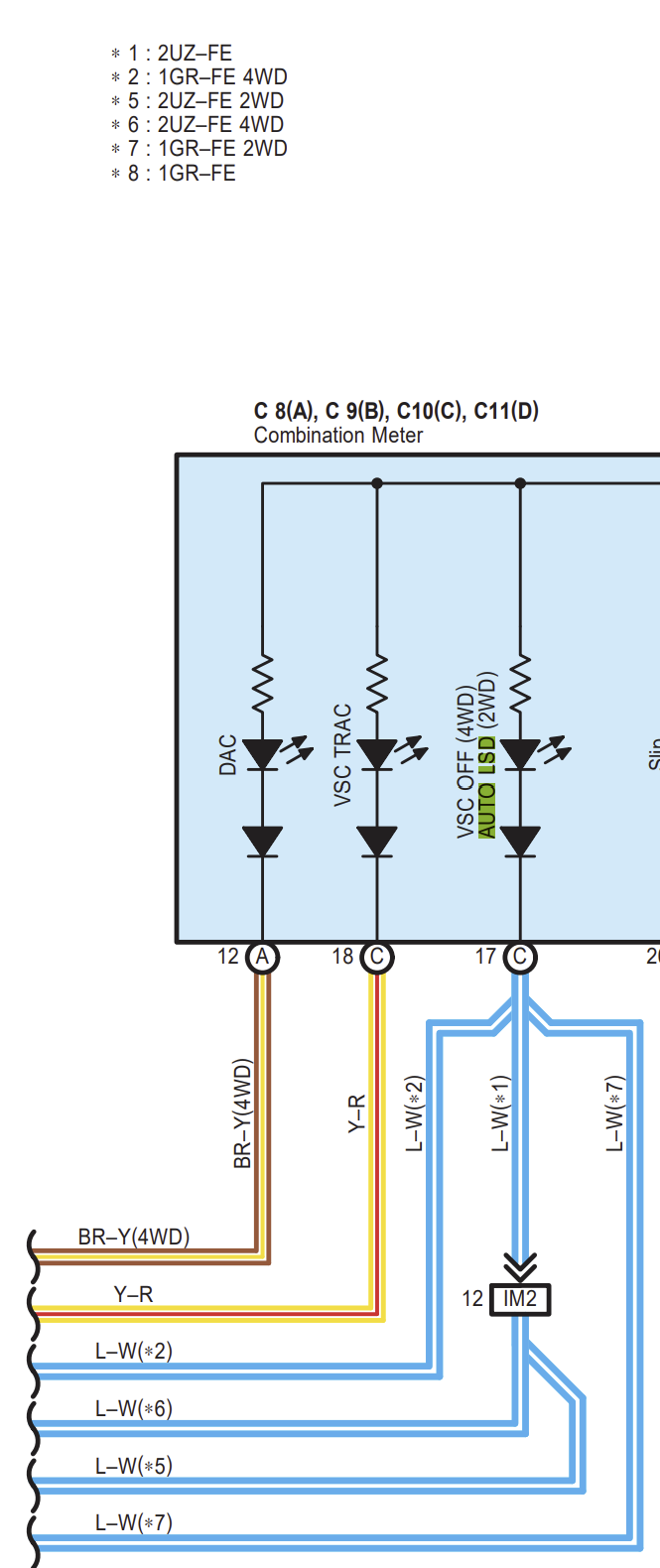

Below you can see the connection between the Skid control ECU and the Instrument cluster. Only VSC indication is present.

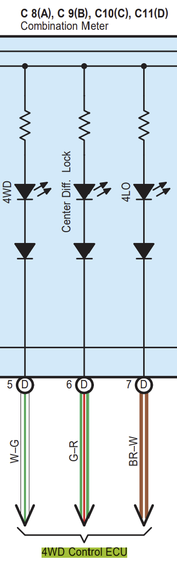

Here you can see the connection between the 4WD ECU and the instrument cluster. Only the 4WD ECU controls the center diff locked light.5.png
Below is a schematic for the mod.

Update-No Workey
Unfortunately no luck. The skid control ECU goes into error mode if the signal from the diff lock is grounded without also grounding the 4wd computer as well.
After looking at a the diagrams I noticed that the green/red stripe wire for the diff lock light from the 4wd ecu runs to the skid control ECU through a junction block. While this is probably to prevent a situation where the diff is still locked but VSC is turned back on, there must also be checks happening to verify that the diff indicator is lit before disabling the VSC. If you watch closely when locking the diff you'll see a delay between the diff lock light coming on and VSC turning off.
I'd like to know how Kliv was handling this with only 4 wires on his board.
