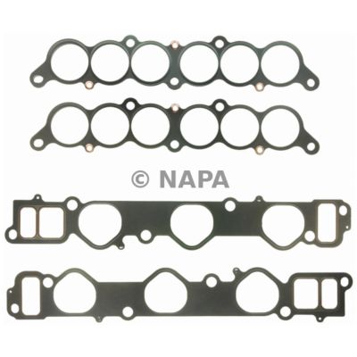

9 96-Runner New member Sep 1, 2015 #1 so i bought this gasket and matches what i pulled off. any ideas how 2 install properly? or is it 2 sets? Attachments gasket.jpg 20.4 KB · Views: 151 Last edited: Sep 1, 2015
gamefreakgc Elite Member Sep 1, 2015 #3 Bottom two are for the intake manifold. The top two are for the plenum, the big silver thing on top of the engine. Unless you're going to tear down the whole engine, don't bother with the intake manifold just to change a gasket.
