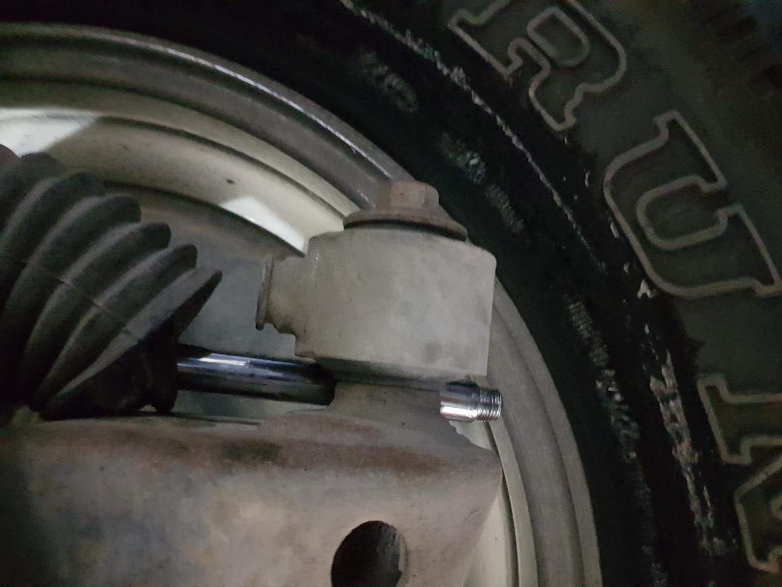

So the buddy I sold my Bilsteins to calls me up and says his rear shocks are acting funny (thought it was blown) so we take a closer look and the shaft seems to have worked it's way loose from the lower eyelet!
We are still unsure of how it happened, with the shaft unthreading itself from the lower eyelet. Most of the threads seemed ok and we are able to tighten it back in there tight

Dang well i might be parking my rig the next couple days to check this on my rears that i bought off a shop from another members rig.. that’s scary, glad your friends ok thank you for sharing
This was a common problem me and a couple of my buddies had experienced with on our bilsteins 5100s rear shocks on the 3rd gens. There were also a lot of people with the same problems. Try putting red loctite on them.
One of the shop guys suggested a spot weld.. but loctite seems to be the better idea

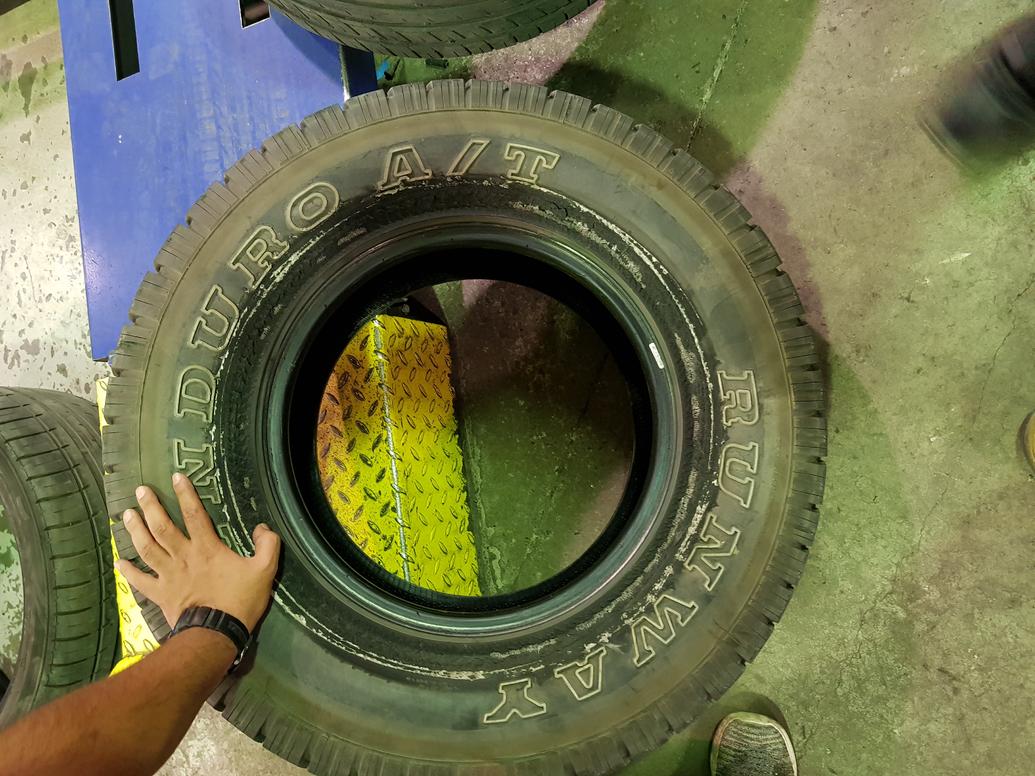

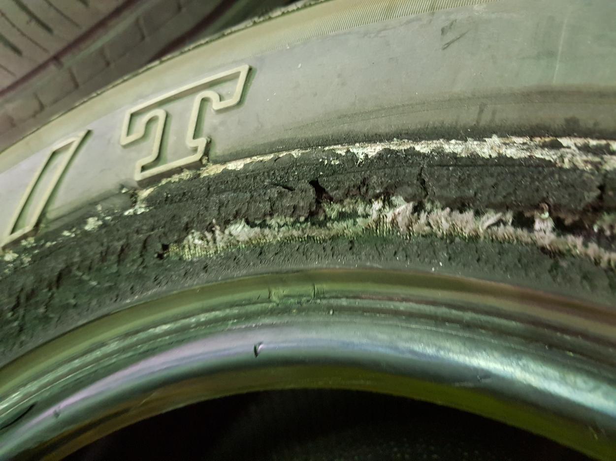

Some more carnage shots of the damaged tire:
