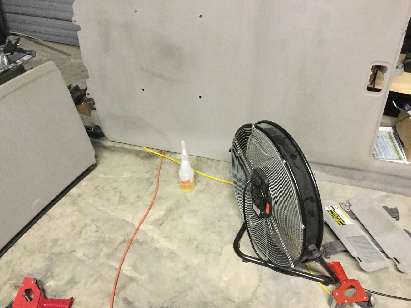

Previous owner had a dog and smoked like a chimney. The truck was just gross. It's hard to believe how filthy it was. I took out the seats and carpet and pad. I threw away the pad and am replacing with some new padding I ordered on amazon for $39 shipped. I mixed a product you buy at the dollar store called Totally Awesome with Tide fabreeze laundry detergent in a bucket with a little water and then brushed that vigorously into the carpet and the seats and power washed them all. I honestly can't believe how great they turned out. Everything looks like new and smells great. It's a big job but it was well worth it to me. Make sure to get some good strong fans blowing on everything or it could mildew. Also, as mentioned earlier do not get the backs of the back seats wet or those boards will fall apart. I just popped them off the seats and cleaned that section by hand and avoided them with the power washer. Now I just need to figure out if the headliner can hold up to the power washer. Good luck

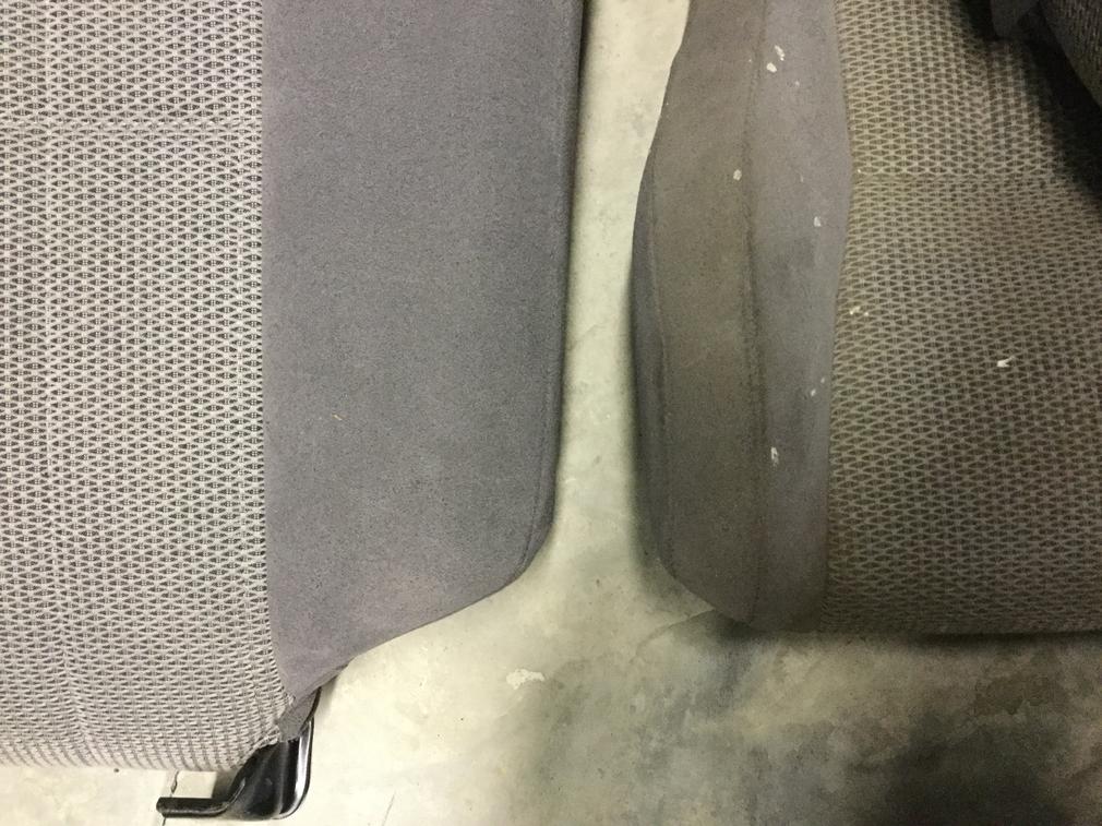

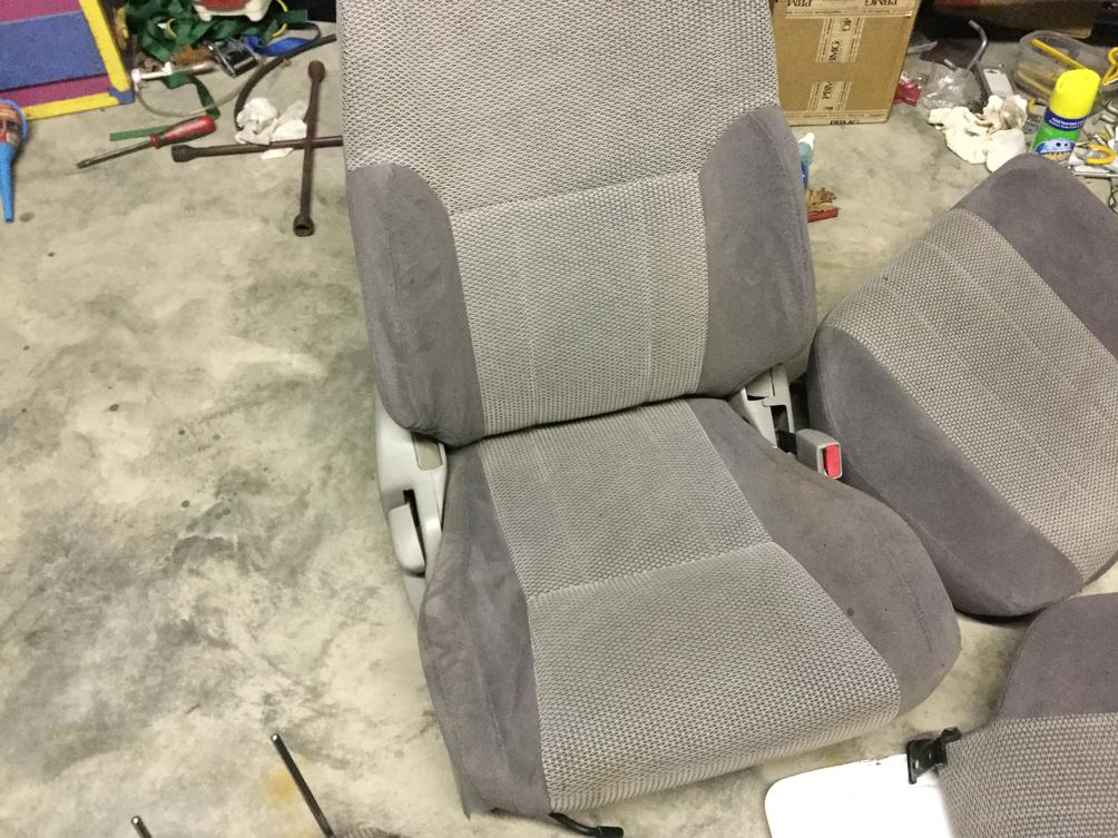

The interior was so gross I figure I had nothing to lose. I used a brush and used The dollar store totally awesome cleaner. I ended up doing my headliner, visors and my seats as well as my carpet. I put the power washer set on a 3 inch fan instead of the hard narrow stream. It turned out fantastic it looks and smells like new. The seat on the left is the after, the seat on the right is the before. The tide really helps them smell better too.

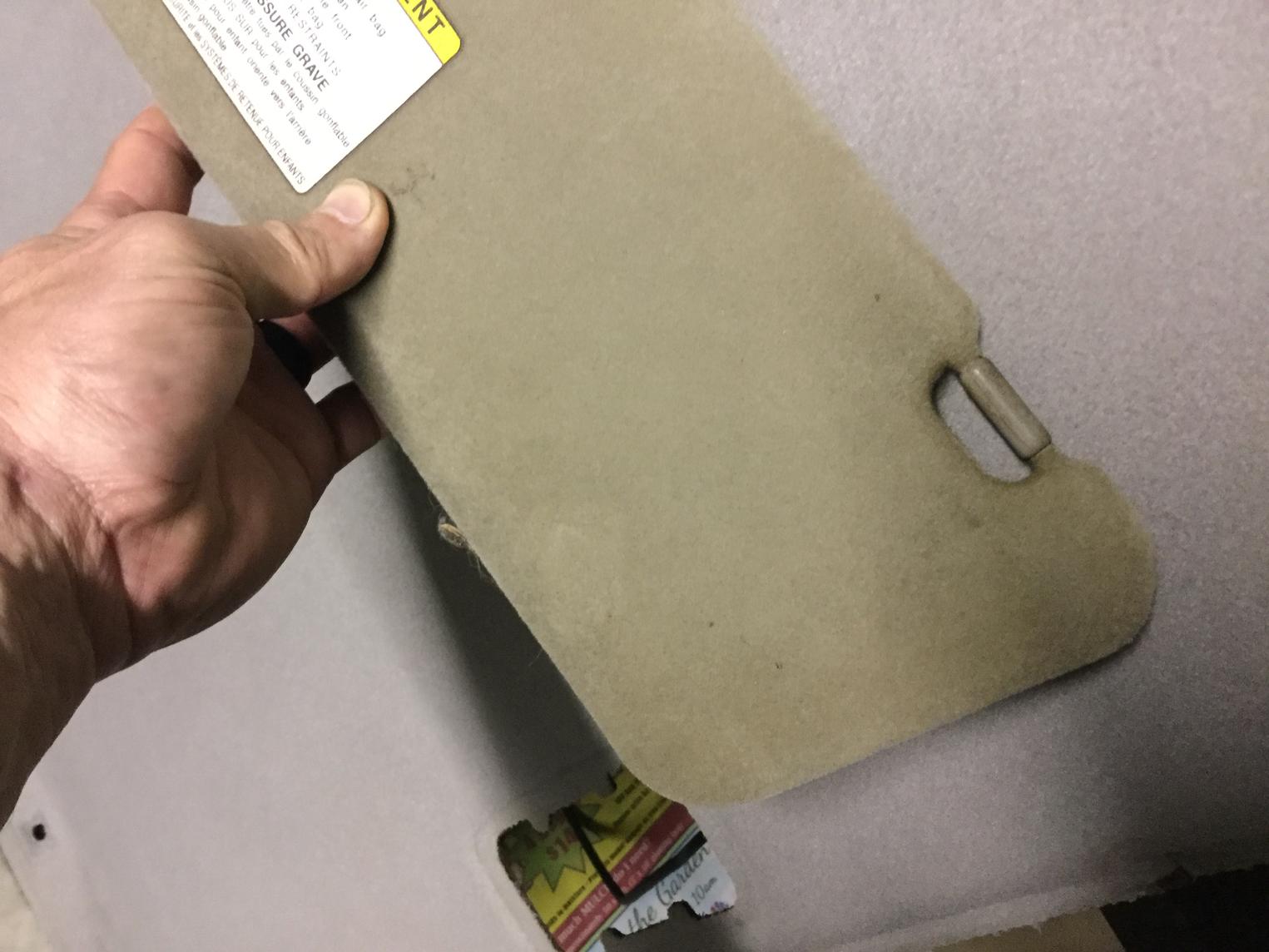

Here's the headliner after and a visor that I hadn't done yet

Some more pics. I'm really happy with how it turned out. I was going to buy a new interior from a wrecked one. This now looks great.
