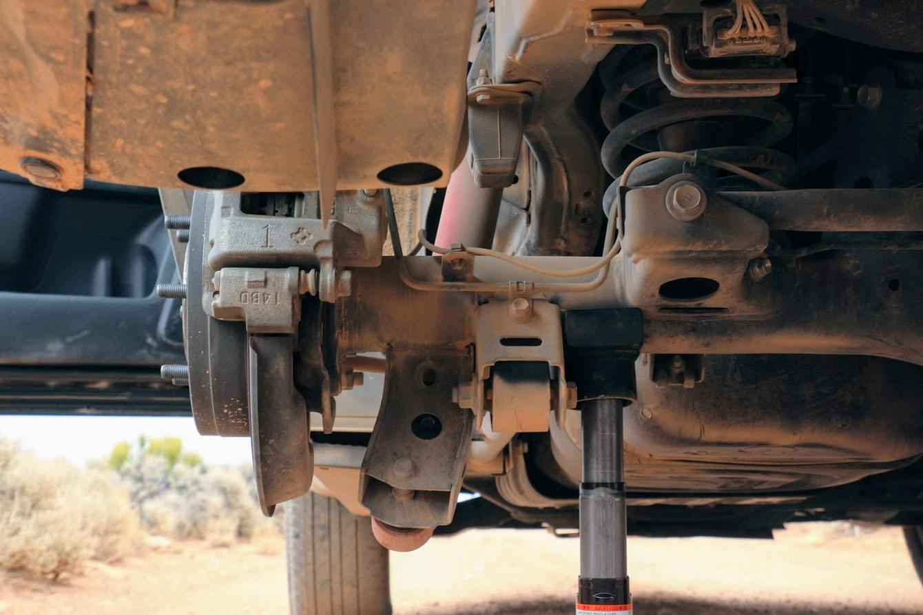

I carry a harbor freight 1.5 ton aluminum floor jack and a 48" hi lift.
The floor jack is for anything I can use it for. When I can't, that's when the hi lift comes out. I also can use it as a hand winch if I need to because I go out solo quite a bit.
Sure having both is heavy- 31 pounds for the floor jack and 28 for the hi lift, but it's still lighter than a winch and a bumper!
I've been thinking about welding up some of these the stock bottle jack and ditching the floor jack, but I'm not so sure it would be worth the weight savings since the floor jack is soooo nice to have.
