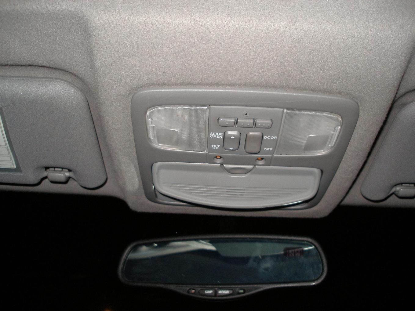

The Lexus GX470's OH console has these LEDs built in, much like your Pilot. The GX470 OH console has two amber LEDs and looks great! Illuminates just enough.
These consoles fit perfectly in our 4th gen T4Rs, however the connector is different. I bought one and had to do some wiring modification (this also has the "door" option so these map lights come on when you open the doors). Definitely happy with this mod.
Thanks - I got it from a junk yard (car-part.com) and if I remember correctly, it was $75-$100 ish. New they are over $900! I think I just lucked out when I got it. I had to phone a couple yards to ask them if they had it. You may luck out as well and the price may or may not be the same.
It's one of my favorite mods though...

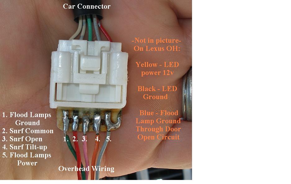

Anyway, I don't have a write up per se for doing the overhead console swap, but I can definitely give guidance. The first thing you will notice when you get your Lexus OH, is that the connector receptacle is different. At least they ran wires to it and it's not part of the assembly like on ours. I removed the receptacle from the OH and to keep as much length as possible, removed the pins from the recept, then cut the pins off. It's just a habit I have to ensure I have as much wire as I may possibly need.
Ok, Then I went through the tedious task of identifying what every wire did (but you won't need to since I already did). Assuming your 4runner has a sunroof, there are 3 additional wires on the Lex OH. These wires are for the LEDs for the ambient lighting (12v & ground), and a ground for the door open switch. On another connector though is the microphone wiring.
You may choose to wire it up a different way completely. However, this was the way I chose to do it in case I ever wanted to reinstall an original OH again. Thinking back, I probably would have done it differently by simply putting a mini-molex on it for all of the wiring, to include the microphone wiring.
I again went through the tedious task of identifying what every wire did. Then I used a Dremel to cut the plastic connector receptacle off of the 4Runner OH (it is actually a molded part of it). I used a sanding drum to smooth it out completely. With the 4R recept removed, I prepared it to attach the Lex wires and pressed on with soldering.
The picture I have included is at this point.
I then cleaned it up with alcohol, put some epoxy over it, and wrapped it. The wires for the LEDs, door open, and microphone, I originally put in a D-sub connector, but later changed out to a mini-Molex connector. Obviously, just check twice & even three times to make sure the wires match up. Not only will you cause yourself headaches, but you can burn something up.
Which leads me to my next comment:
Do this at your own risk!
