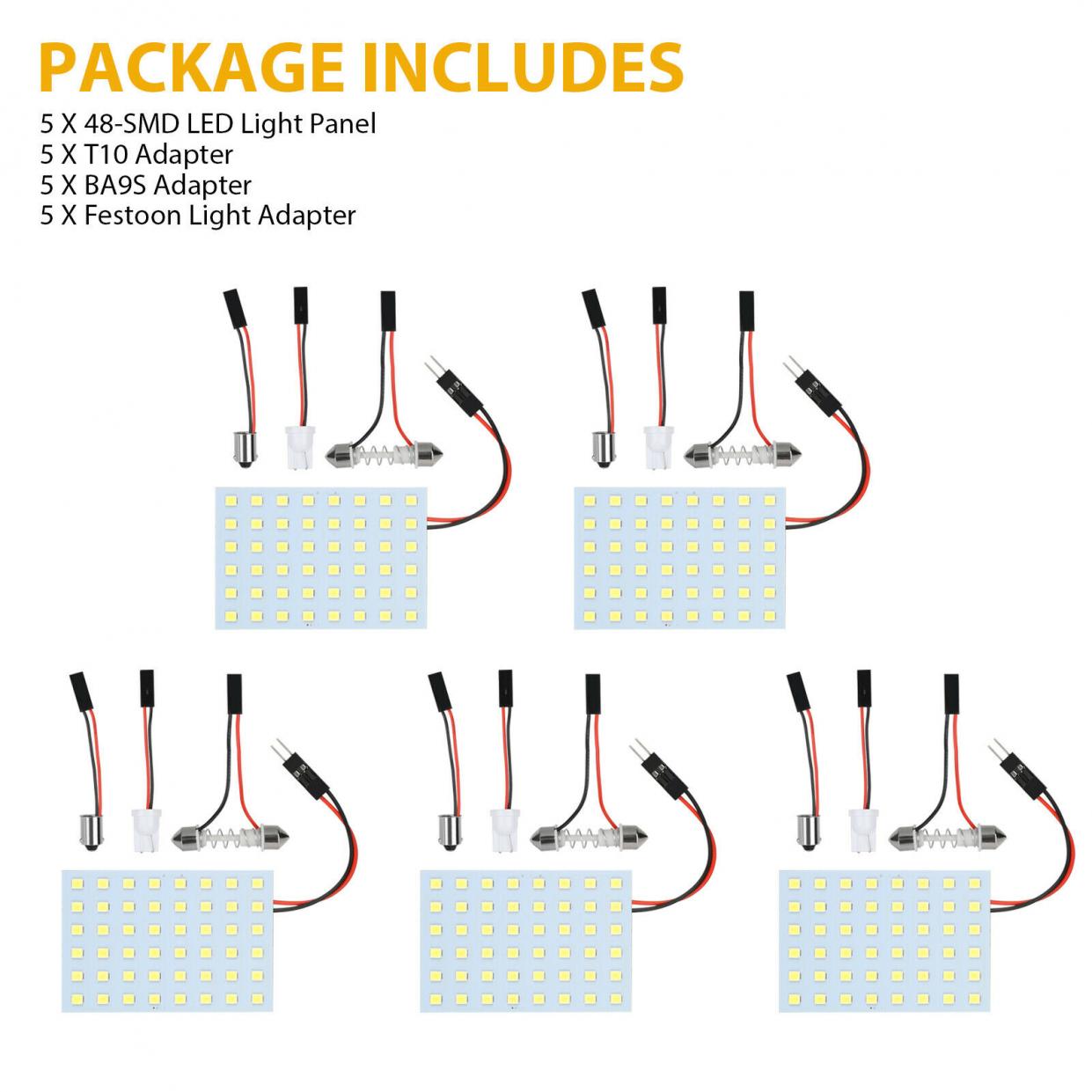

I couldn't get superbright's single leds (or anyone's) to do the job for the two
interior lights, so I went big...
I have something very similar in my dome lights too. I got kids and was tired of not being able to see anything inside the vehicle at night! Plus helps with diaper changes in the cargo area.
