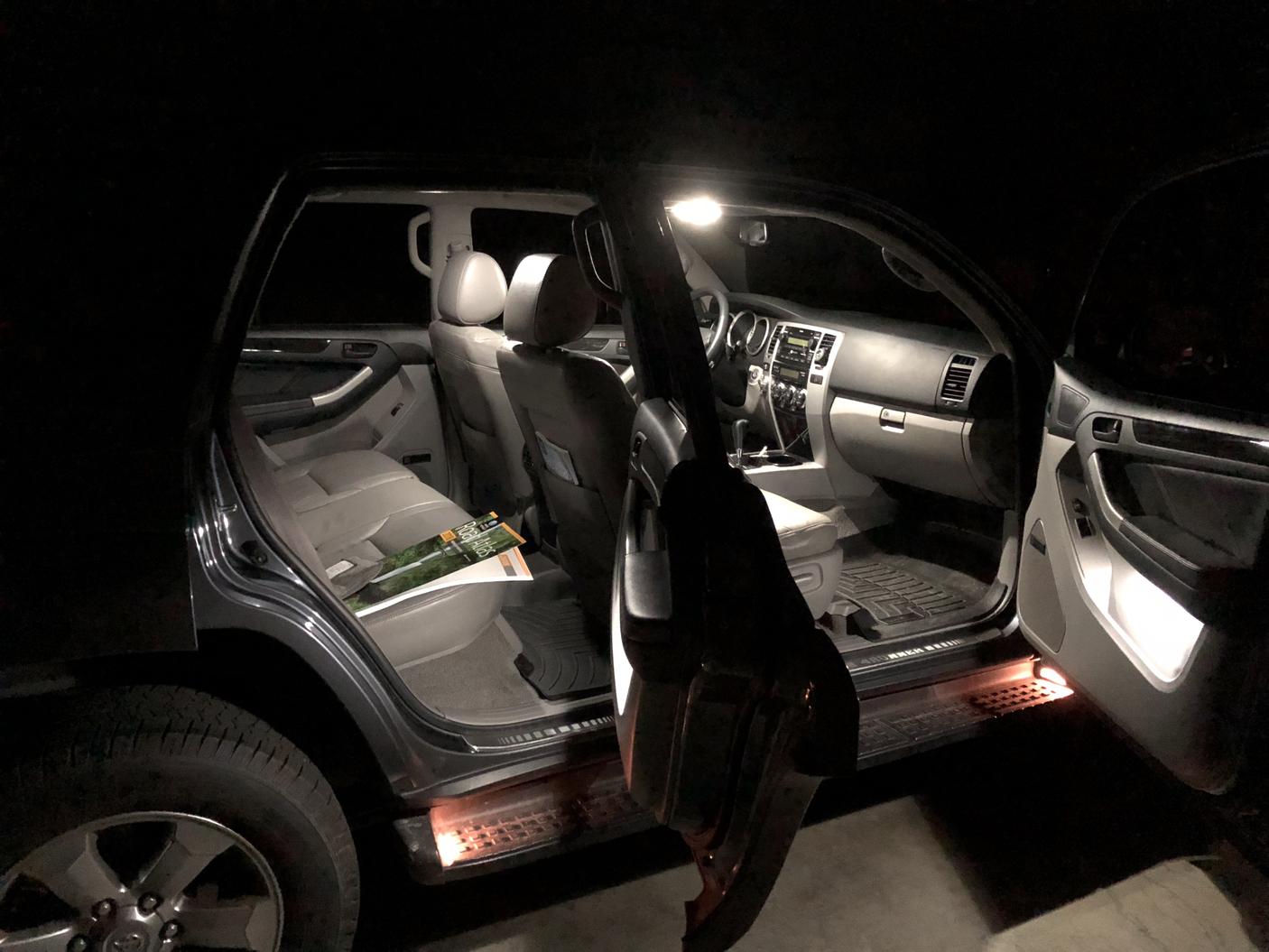

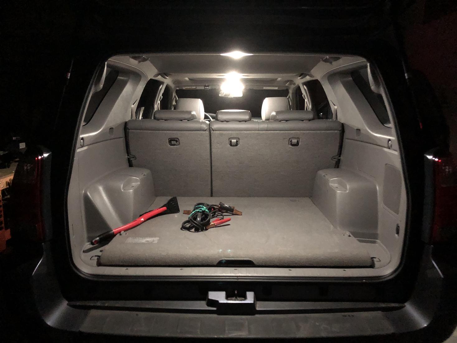

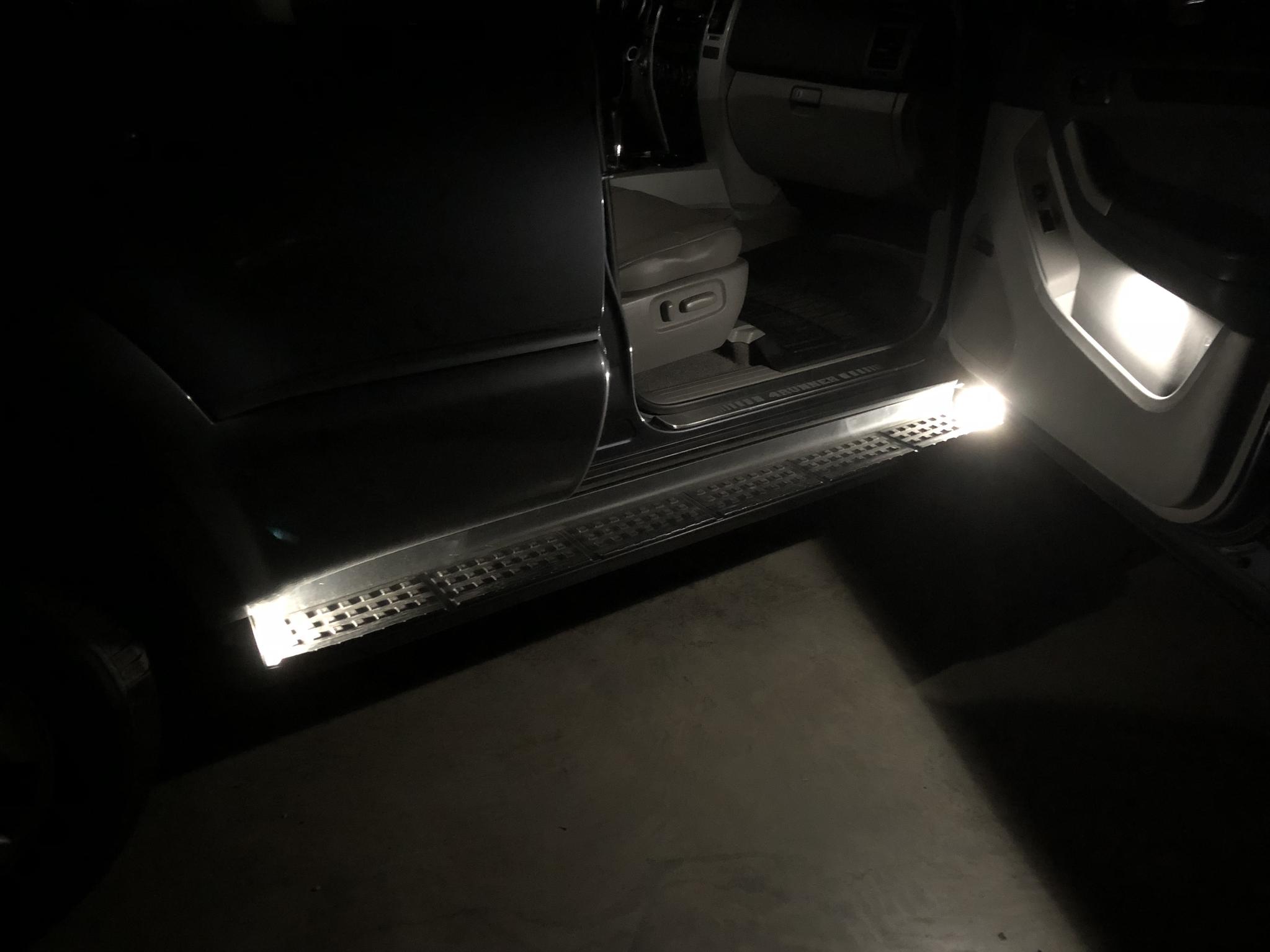

VLED Replacement
Just replaced all interior, including visor and glovebox, running boards and license plate with 5000K VLEDs and extremely happy. Better looking and brighter. Replacement was easy across the board, but the glove box one is hard to get to.
One of the pictures the running boards haven't been replaced.
