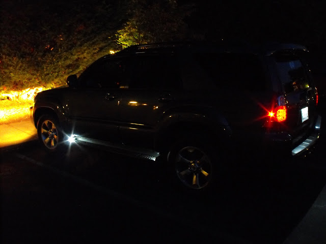

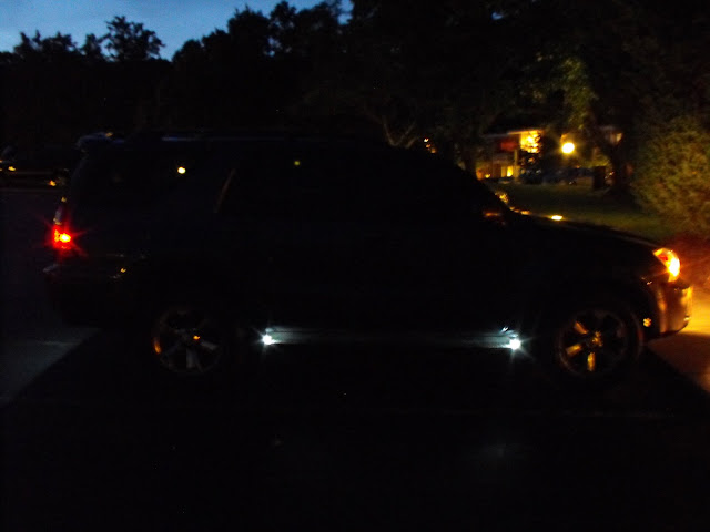

here are some night pics:

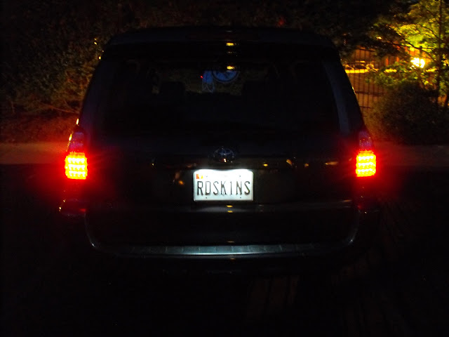

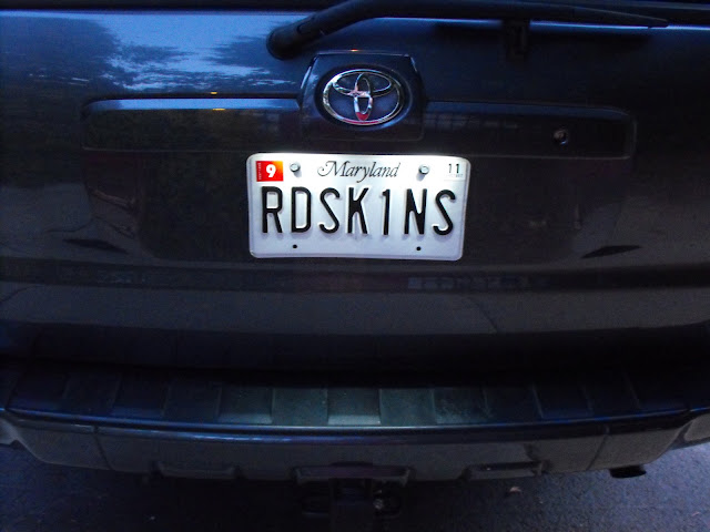

and the license plate leds:

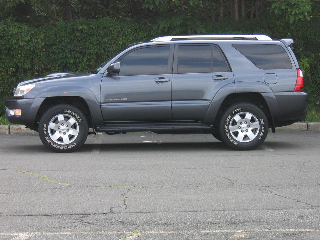

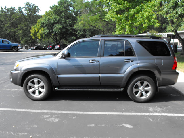

this one shows the mismatch when using 20% tint. thinking about putting 35% on the rest to balance out more:
If you were to take that same picture again, but with both passenger side windows down, your 20% tint will look like a perfect match. Have you ever noticed that the tint on the front two windows looks darker than the other windows when you're on the inside looking out? That's why your front window looks darker than the rear in your picture--because you are looking at it from the outside, but with the passenger side glass behind it. If you put down both passenger side windows and take the picture again, I bet it will be a much better match.
good point...all the more reason to do the whole rear. do you think 50% or 35% would be better? I also took a look at the warranty and it says 15%. Im going to call them and see if they really put 15 when they told me 20.
I have 20% on mine and it seems to match perfectly.
I need to get some pictures of mine, but I also did 20% on the front and its perfect. From the inside you can tell the difference between the OEM glass and the tinted windows, because they have a different base color. It actually looks like the back isnt tinted (clear looking out), while the front is (darker). But from the outside they look the same.

does anyone know which bulb I need for my running boards?
thanks
mikeh
You can use the 168/ 194 bulb for the running boards, license plate, map lights, and door lights.
