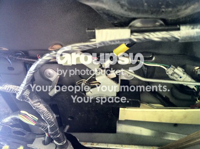

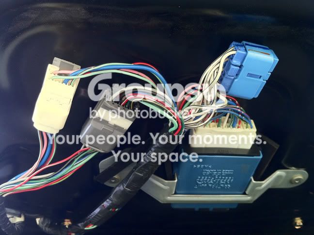

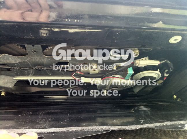

So I went back in and took some pictures, but still haven't had any luck fixing this, I guess I'm going to have to take it in to the shop they quoted me $160 to fix it, $130 for the part from toyota.
liftgate3.jpg~original
liftgate2.jpg~original
liftgate1.jpg~original
