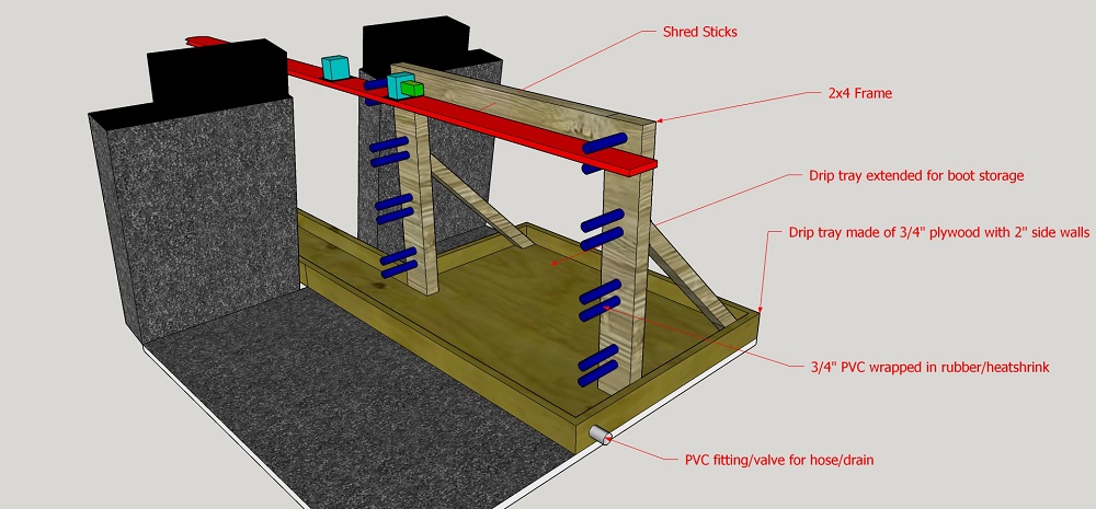

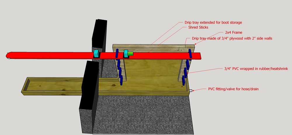

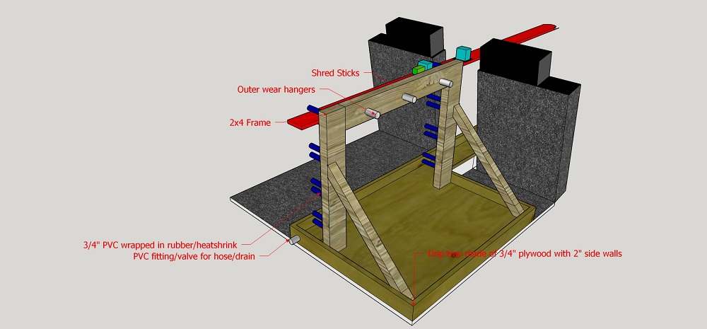

Drew this up in sketch up for you real quick.
If I were going to build it, I would do something like this. Probably just do like 6 good coats of polyurethane on the plywood tray, or if you wanted to get super fancy I guess you could step it back to 1/2" and glass it in. That starts getting pretty involved though. For securing the skis, just some bungees and eyes strategically located to hold them in their PVC slots should do the trick.
It's roughly to scale using your badass 190s. Hooked you up with some sweet bindings too.

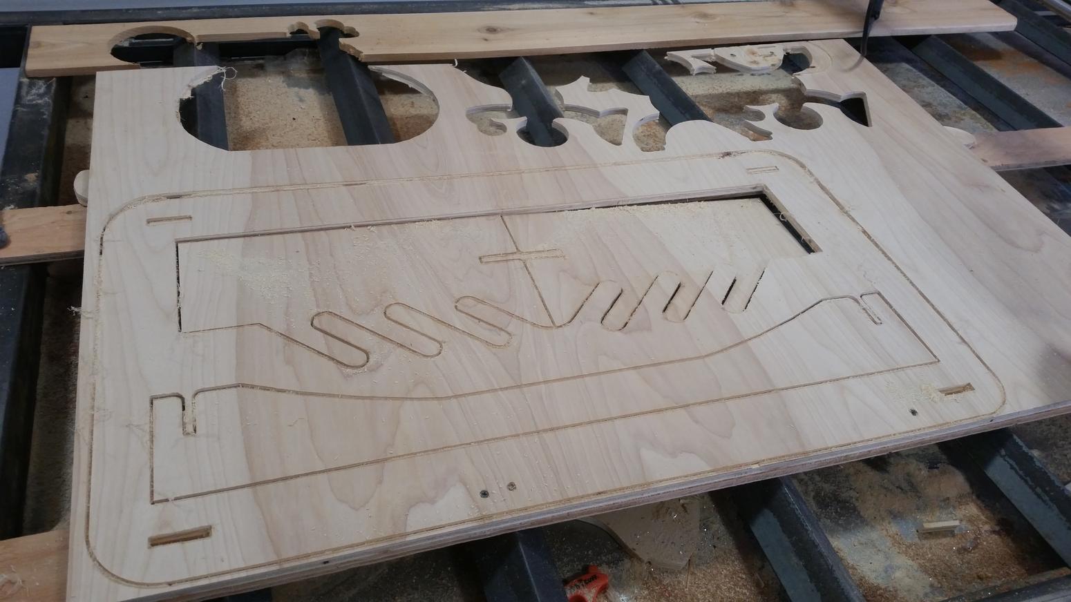

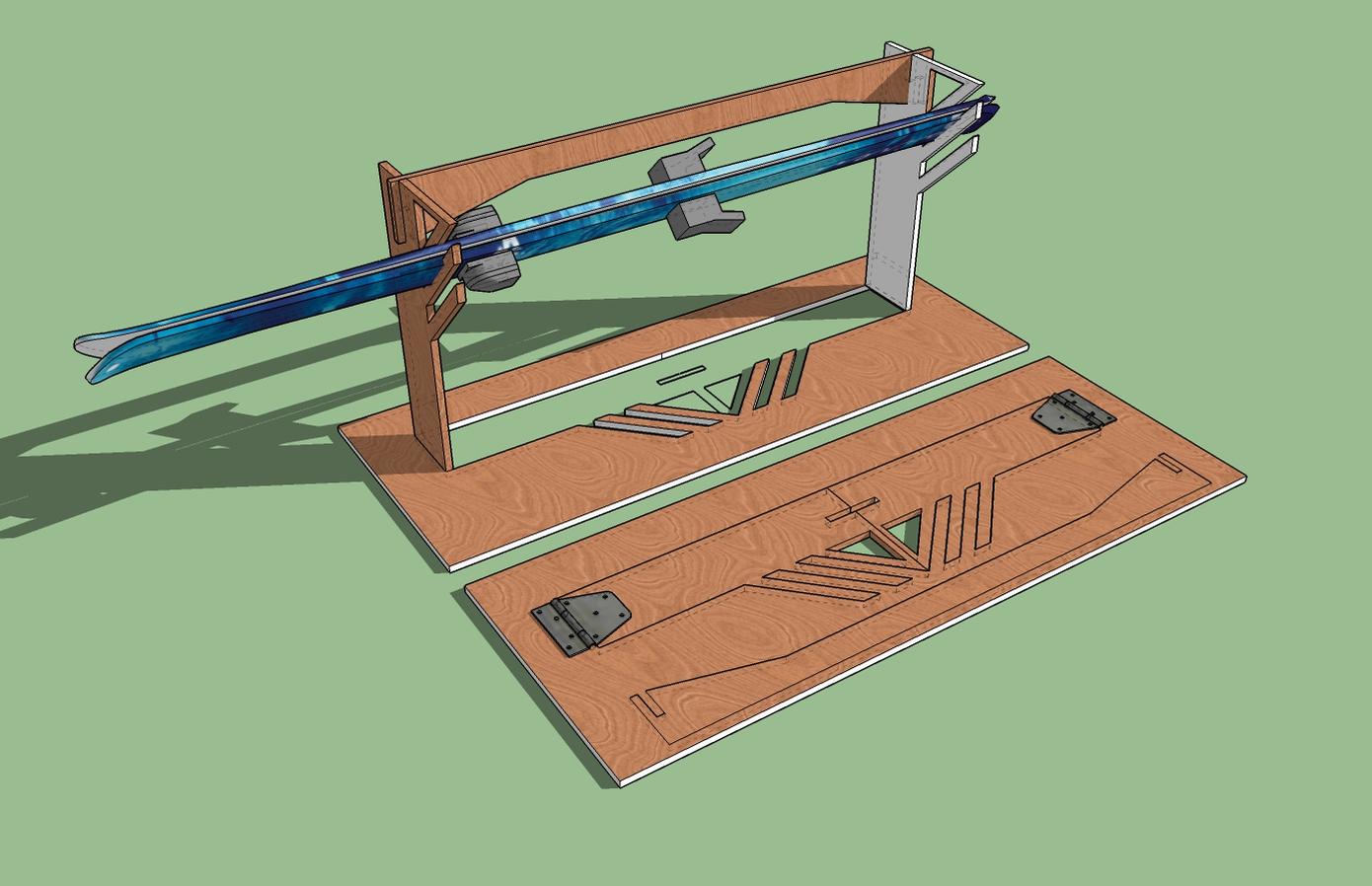

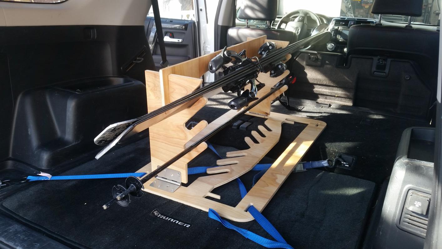

I drew this as a quick idea of what I might go with. I have a 4x8 foot table cnc router so I'd just need to measure to make sure it fits correctly in the 4runner. With the wood and some adjustment for making it look nice and curvy it should be about a 20 minute cutout on the router plus some time to paint it or whatever. It's kind of a chincy Ikea design, but for me it's easy and fast. I still need a catch basin though. In a perfect world I'd cut out of foam and fiberglass it, but in the real world I just don't care enough to make one that nice.
It will fold up almost flat for storage.
Dude, make it out of better materials, patent it and ... ka ching!

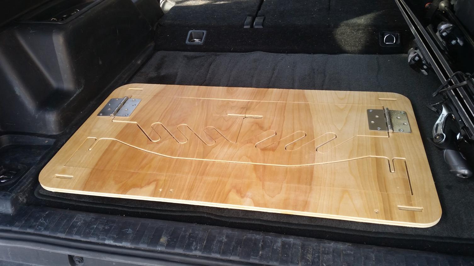

Still needs a catch basin. But it works.
