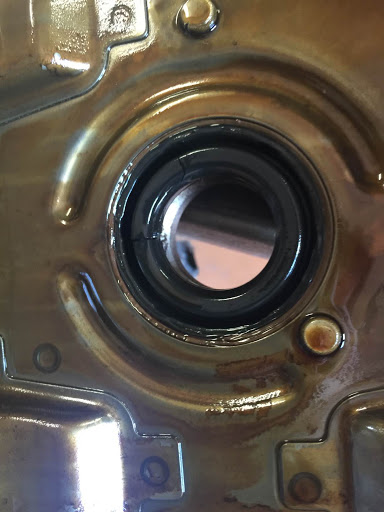

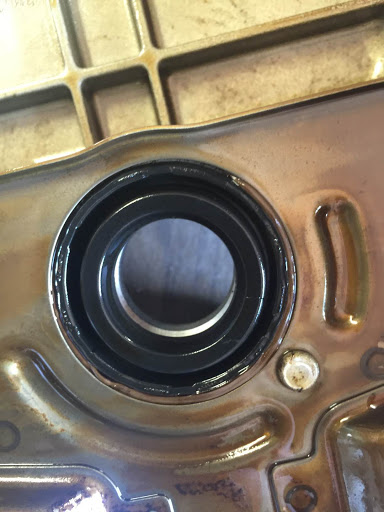

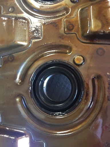

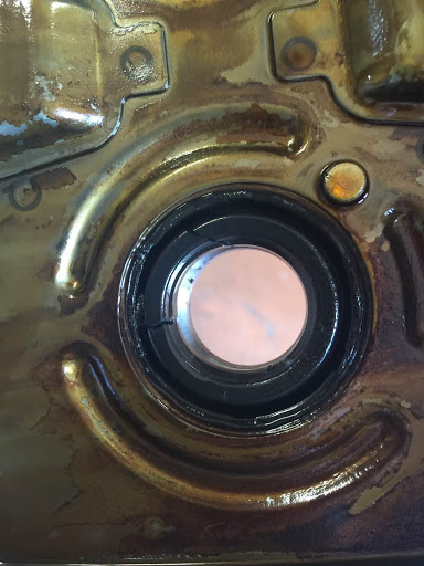

Looks like this was the cause. Those gaskets are shot.
