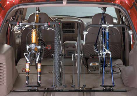

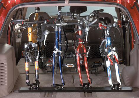

Saris
I got this idea from Harper's posts. If you want something to just buy and install, the system below works awesome. I ended up buying the saris traps from Jenson USA and screwing them into some aluminum channel 30" long. I have to remove my seat post but I love this system so far.
Traps Single Track
Saris Traps Fork Mount Carrier at JensonUSA.com

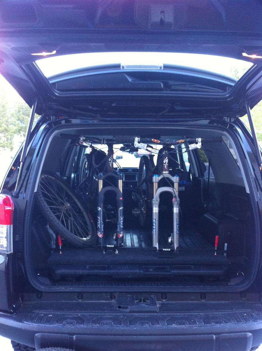

Here is the setup I built. It cost about $60. The main cost is the thule fork mounts. It is kind of a hassle- I have to remove the seat posts for the bike to fit. I think it is less of a hassle than trying to get the bike on top of the car, plus it is more secure if I want to go riding right after work.
