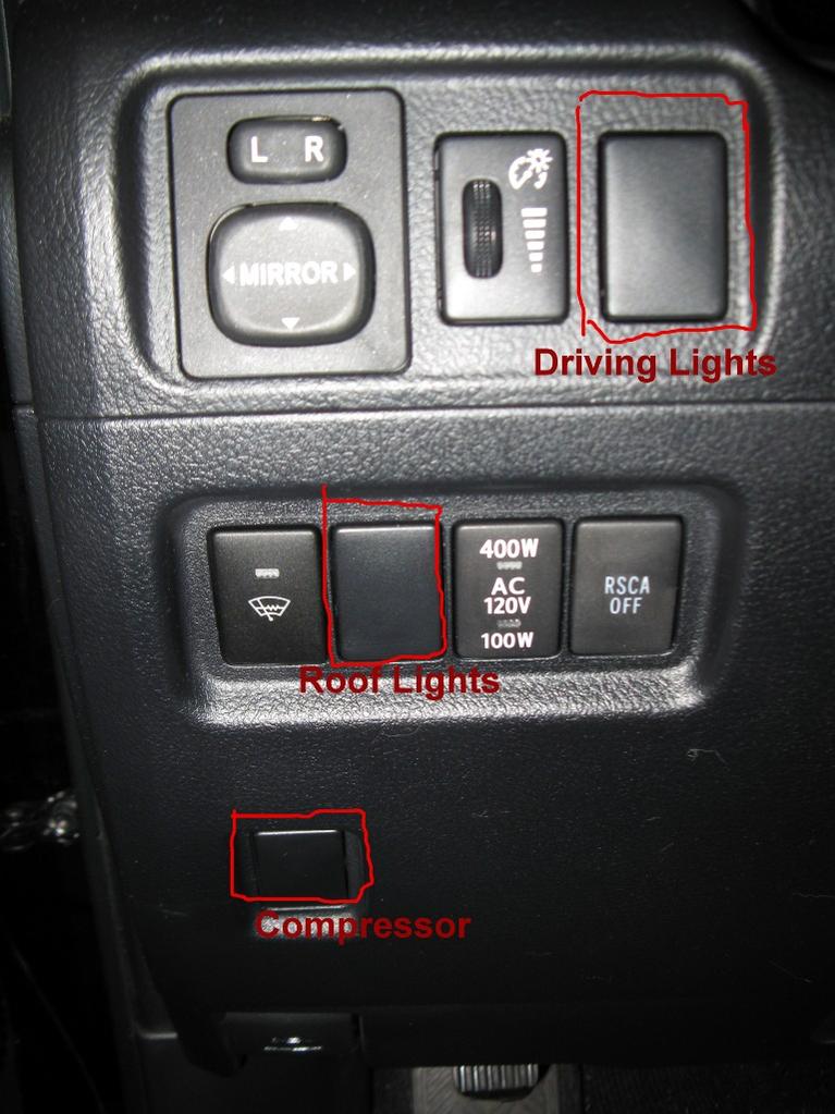

Philly, depending on the switches you are planning on using, the stock locations will not work. the switches I used are taller, so you'll need to modify the hole (can be done, but it's nice to know ahead of time).
If you are planning on using the location that is marked "Compressor" in the attached image, BE VERY CAREFUL!
That location has various step-downs molded into it and if you mess it up you'll be using a LOT of JB Weld to fix things. If you are planning on using the contura switches like I did, send me a PM with your number and I can talk you through the issues I ran into. it'll be easier to talk through than try to type up in a sensible manner.
Okki
PS. I Did NOT use the locations as indicated below for the lights; I installed a fresh bank of switches. see my build thread for details.

Plan is to use the spot you called Driving Lights. What you called Roof Lights is option B. But we know what happens to plans after contact with the enemy. Question is how to get that trim off to get access.
I'm using a Toyota rocker switch like this: Susquehanna MotorSports - Auto Performance Product which I understand will take some trimming.
Grab that panel and pull towards yourself. It yanks right off and them you can disconnect the wires. Doesn't get any easier!

Hi PhillyD2, I used a different switch, so I can't speak to the installation challenges you might run into, but the covers just pop out from the back. drop the lower half of the dash, stick your hand up there and push. Be careful though, because there is a LOT of sharp metal behind the driver dash; I sliced my hand open pretty well (left a couple scars) when I was running the wiring on my installation.
The panel is the one around the one labeled Driving Lights in the picture above. Where the hell does one grab to pull?
Open the driver's door and stand outside the truck. Right hand on the right side of the panel by the steering column, left hand flat pressing against the left side of the panel, and pull towards yourself. Use some muscles, man! Don't be skeered, it will not break. Promise.
