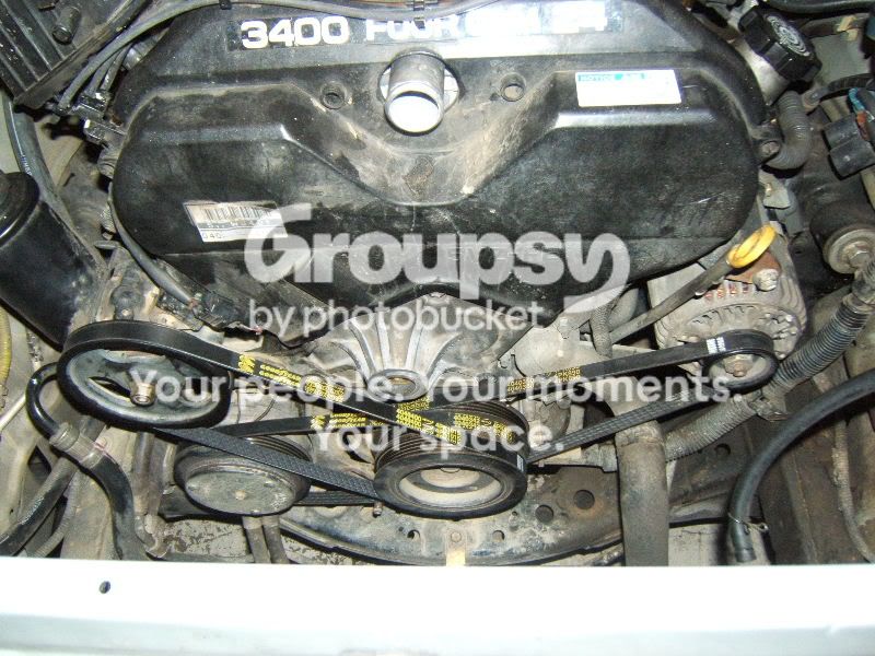

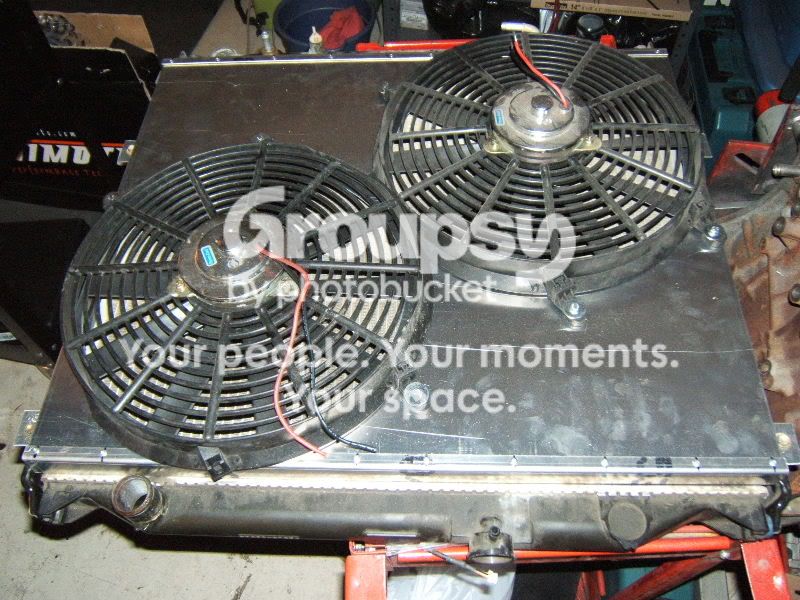

New fan shroud on the radiator ready to be installed. I did most of this work at home, so quality isn't quite what it could be, but overall i'm super happy and fitment is good.
2008_1214image_0018.jpg~original
Fan bracket after meeting my chop saw. Not the safest way to cut this thing down, but it had to be cut down, so i did what i had to!

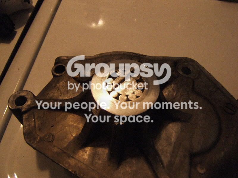

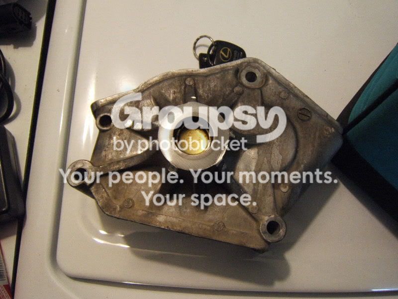

1" freeze plug sealed it back up after i gutted the center of the bearings out. I would like a cleaner finish on this, but it will have to wait. Right now its functional, but just not as pretty as i would like. The other problem is that w/ the new belt routing it runs the alternator belt too close to one of the bolts that mounts this, so at some point i need to machine the corner down to countersink the bolt.

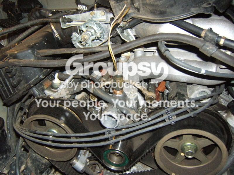

First attempt at triggering the fan..... the switch wasn't working, and it wanted to leak. I knew it was a bit risky going into such a thing piece, but i was hope full. No such luck just wanted to leak! I tried a couple of solutions, but at the end of the day i took a brass bushing in the 1/2 x 3/8 NPT, and threaded it in then brazed it. to keep it from leaking. The switch itself i ended up switching to a Honda unit from the 80-early 90's era. Works great so far!

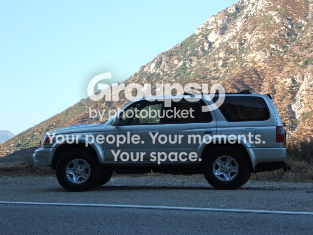

Where in SoCal are you? It seems more and more are 4Runners are showing up here lately, that looks like this photo could be in Trabuco Canyon...
Welcome to the 4Runner life!
i'm currently in the rancho cucamonga/ontario area ... pics were taken on the way up Mt baldy.
I should also mention the reason for such an extreme change when going to the electric fans is that the bearings in the fan bracket were starting to make some noise. otherwise i would have left the stock sized belts on it and saved myself some work.

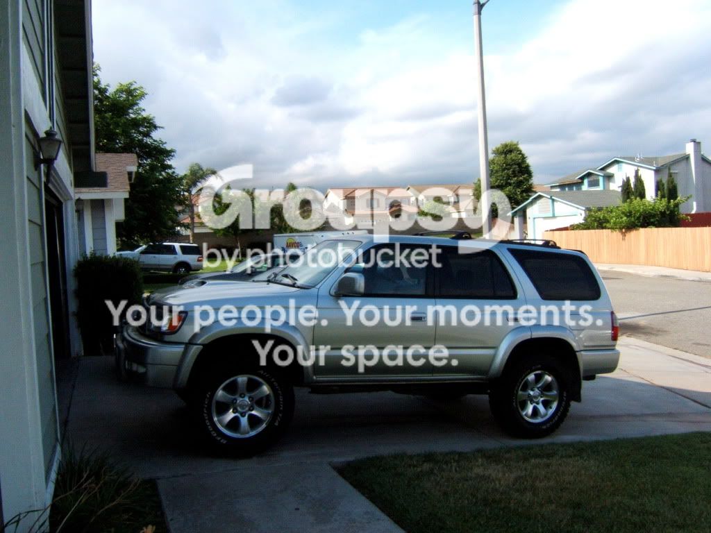

after breaking a belt in one of the cheap Remington tires that were on the truck when i bought it, an upgrade was needed.
2009_0526Image0001.jpg~original
265/70/17, got them used w/ the wheels for a good price. The wheels fit pretty well, they seem to sit a little farther in than stock, and will rub a bit on full lock, but nothing to major. I will probably try some wheel spacers in the near future.
The next problem of course was that the tire was an 1 taller, but the truck was not, meaning it was time for at least a little lift.
4r.jpg~original
I ended up going w/ the 99 "tall" springs.

I got the fronts used off of yotatech for a good price, and the rear i got for free from sikhiluxsurf. I'm guessing these springs had spacers on them at one time because they felt a little loose. The gesture was much appreciated, but i ended up getting a new set from Carson Toyota for $65 each. If anyone else wants to try these rears in their 4runner, they are up for grabs.
I topped off the set up w/ some new bilstein shocks.
I am supper happy w/ the end result, i can still get in and out w/ out having any steps or sliders yet, and it has pretty good clearance for off road fun. The ride on pavement is perfect for me, but then my cars are set up w/ pretty stiff "race" suspension, so if you are looking for a soft ride, don't take my advice.
