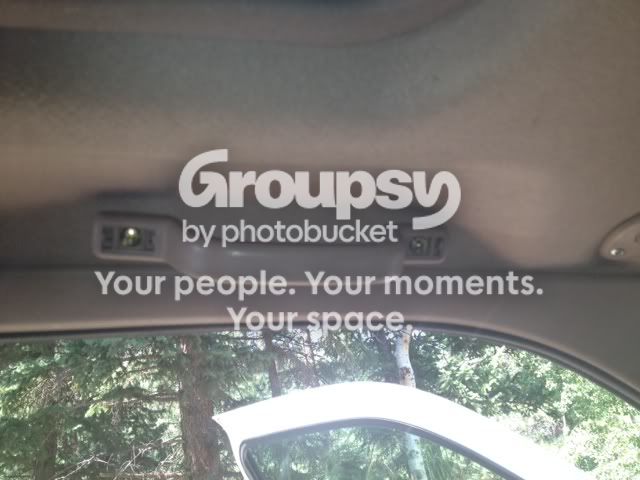

After getting home last night, I was quite frustrated with the map light issue and decided to just do it my way, Toyota design philosophy be damned.
I pulled the overhead module and broke out my automotive multimeter. I tested everything and discovered that the fault was with a design flaw in the unit. The ground half of the light circuit (for both sides of the light) relies on aluminum rivets going between the ground plate, the plastic housing, and the reflector plates. I'm going to ASSUME the lights worked when the truck was new, and that some corrosion in the reflector plates was to blame for the loss of connectivity in this particular assembly. Even if it did work when new, it's a horrible design. I invested in some 1/8" pop rivets, and this morning got to work rectifying things.
I drilled out all of the rivets holding the ground plate, plastic housing, and reflectors. There was some corrosion on the reflector plates (the sort that seems to be common to all of those types of reflectors), so I cleaned it down to the metal, treated it with phosphoric acid, then hit them with some "Mexican chrome" (chrome colored spray paint).
While the reflectors were drying, I shortened the ground wire and moved it directly to the ground plate to be secured with the replacement rivet. I see no reason it wasn't there in the first place, and it makes a much more direct connection that is far less likely to suffer from silly manufacturing errors or poor quality chrome. I crimped on a small ring connector, then riveted the whole thing back together. Once installed, it works like magic.

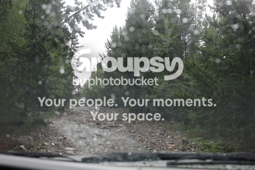

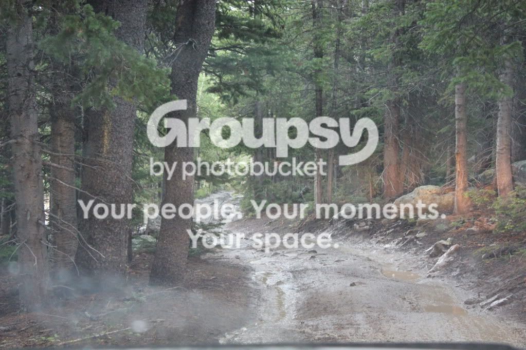

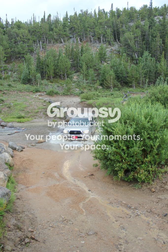

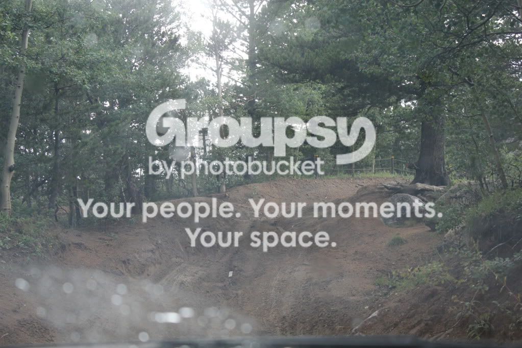

Finally took the 4Runner on its first off road adventure. My friends from Dallas came into town on vacation with their new to them '05 Tacoma. Since I finally had someone up here to go wheeling with, I did some research on Traildamage.com and found myself a nearby trail that looked like it would be reasonably challenging without breaking anything or taxing our non-existant skills beyond the point of discomfort.
According to traildamage, the Caribou Creek trail was about all that some stock 4-wheel drive trucks could reasonably expect to handle, I knew exactly where it was (I've been to the ghost town at the trailhead a few times), and it was close to the house. We went down to Nederland, got some lunch at the grocery store, then headed up to the trailhead. Lunch was had in one of the ruins (super cool!), then we headed off down the (busy) trail right behind a small group of heavily modified Jeeps.
The only issue we had was related to the recently installed topper on the Tacoma: it looks like a wire was pinched between the bed liner and the metal of the bed, which shorted out and blew the tail light fuse causing it to not want to shift out of park without pulling the tab and pushing the release button. It was raining pretty hard (we even got a little hail at the end), and the trail was VERY muddy. The trail consists of some rocky stretches, a water crossing, and a LOT of mud and fairly deep puddles. It was raining really hard and my wife didn't feel too good about getting her expensive camera moistened, so pretty much all of the photos are from inside my truck.

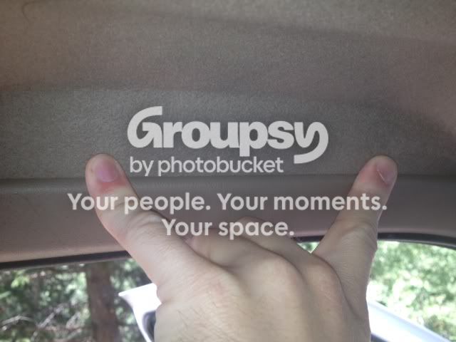

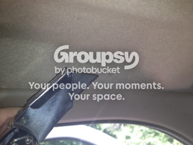

I also did a fun little project that I saw someone do somewhere (don't remember where exactly, probably on here though). I'm not all that tall and when I get to it, the truck will be. I went to the salvage yard yesterday between meetings and picked up a few things including an upper grab handle from the passenger side of a similar interior to install on the drivers' side. The holes and captive nuts are in the proper place for RHD markets, and if you look closely (though it might be difficult to see in the photo) you can see where the holes are through the headliner.
handle2.jpg~original

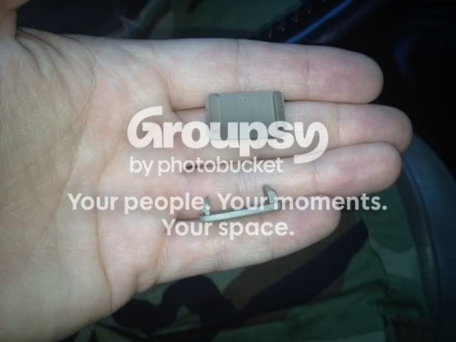

In case you, like me, are curious what the inserts that cover the screws look like this on the inside so you can remove them easier without damaging anything when you go to fiddle with this sort of thing:
handle1.jpg~original
With my razor knife, I just cut two little exes there the holes are and screwed the handle on.
handle3.jpg~original
handle4.jpg~original
I didn't take any photos of the finished product, but you all know what that looks like.

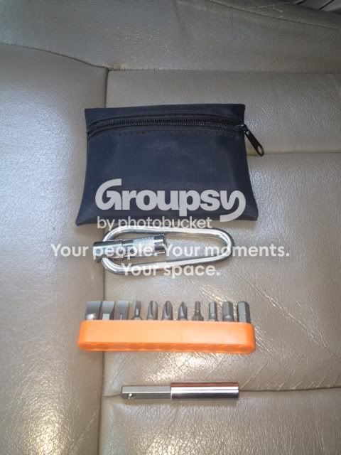

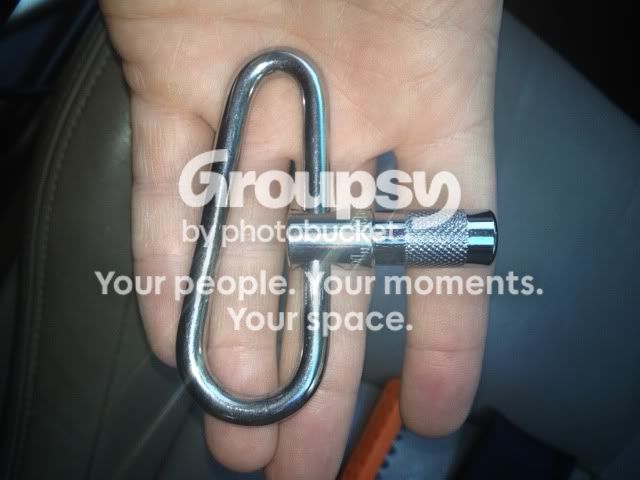

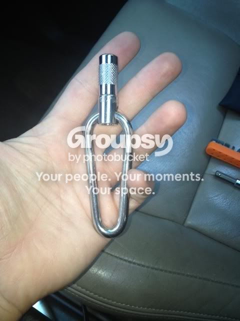

Finally, I thought I'd share a neat little find.
driver1.jpg~original
driver2.jpg~original
driver3.jpg~original
I am in no way affiliated with this company, and the website isn't much to get excited over, but here's the link. It all fits into the little pouch and I will eventually remember to put a few appropriate 1/4" drive sockets in there. I keep it in the glove box and it has come in handy multiple times. When in the high torque position (perpendicular to the handle) it's shorter than any commercially available stubby screwdriver and gives you a lot more torque. You obviously don't need all of the drivers it comes with, but a few extras can be swapped in and out. It's pretty sturdy too, and for $16 including shipping, you really can't go wrong.
