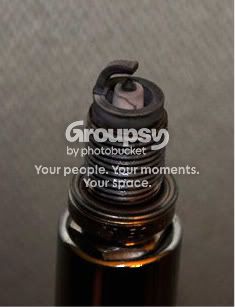

Here's a shot of the plug I discovered at 51,000 miles in my CR-V. Denso SKJ20DR-M11, iridium electrode with the platinum ground pad.
DSC_0322.jpg~original
I believe the V8 4Runner calls for the Denso SK20R11, correct? These plugs are almost identical, and absolutely the same quality. Both are the same heat range, both are resistor plugs, both have an identical gap. The only meaningful difference is that the reach is different. This plug didn't didn't fail as a result of anything related to the "inferior" engineering of the K-block motor in the CR-V (actually, it didn't fail at all, I found it during my inspection, for all I know it would have made it another 50,000+ miles to when Honda wants you to replace it).
My point is that you may want to consider pulling the plugs at some point prior to 100,000+ miles just to see how things are doing, then coat the threads with a light brushing of anti sieze and, reinstall them and go on your merry way.
I did think of something interesting. This plug would have fired far more times than a comparable 4Runner simply because of the fact that the small-displacement CR-V has to spin more quickly to maintain the designed level of responsiveness. I would expect the CR-V would have fired 20-50% more times over the same distance as either of the 4Runner engines.
