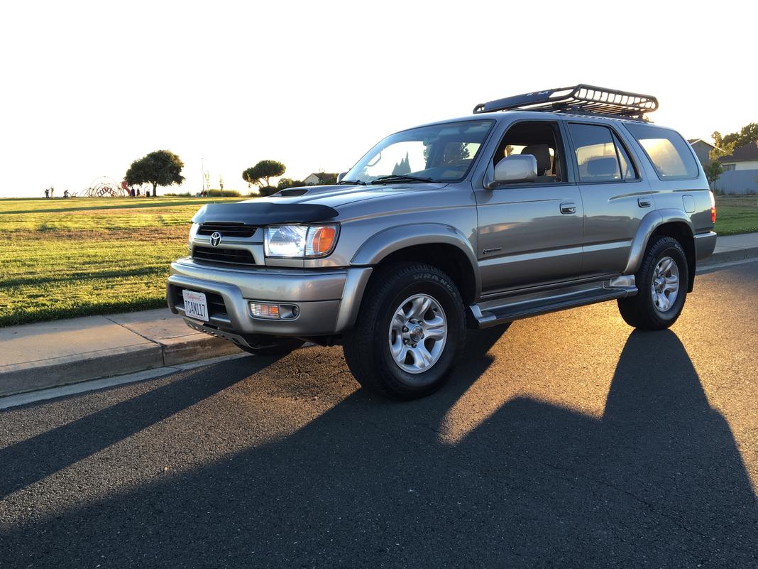

Here's what the truck looked when I got her

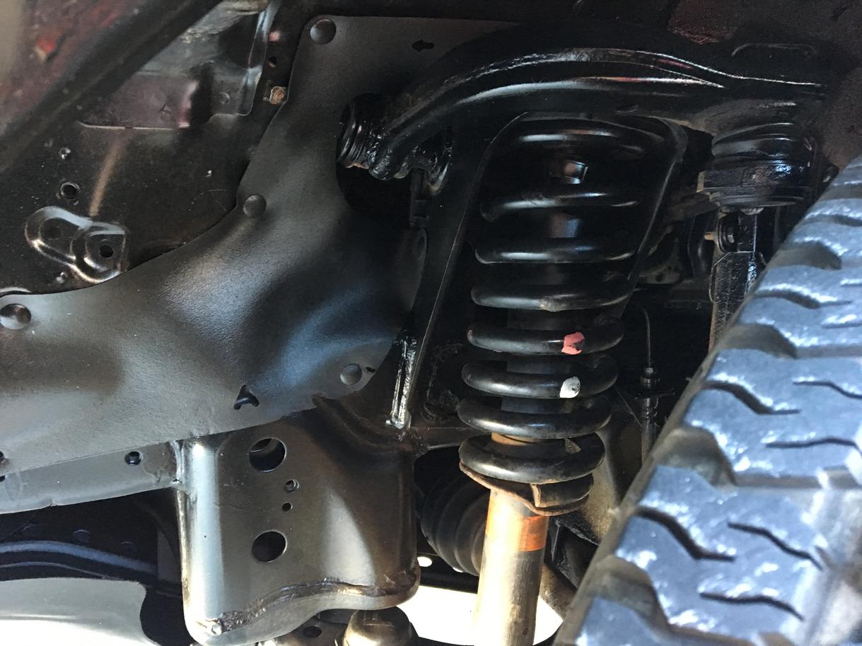

Quick update
Haven't really don't much to her lately, the only major thing I've done was clean off and repaint the under carriage.
The truck came from Utah so it had some surface rust, but the previous owner tool really good care of it and fortunately the rust wasn't a huge issue, just some small surface rust. Now it looks like it came fresh off the lot. I used an angle grinder with a 4" wire brush. And for the smaller areas I used my dremel and got a bunch of wire wheels for it.
After getting rid of the rust I blasted the frame with some break cleaner so clean off the surface, whipped it off with some shop towels and sprayed some rust reformer. After that I repainted the area with fresh chassi paint. Here's a small sample of what it came out to look like. I'll try to load some better ones when I get under her

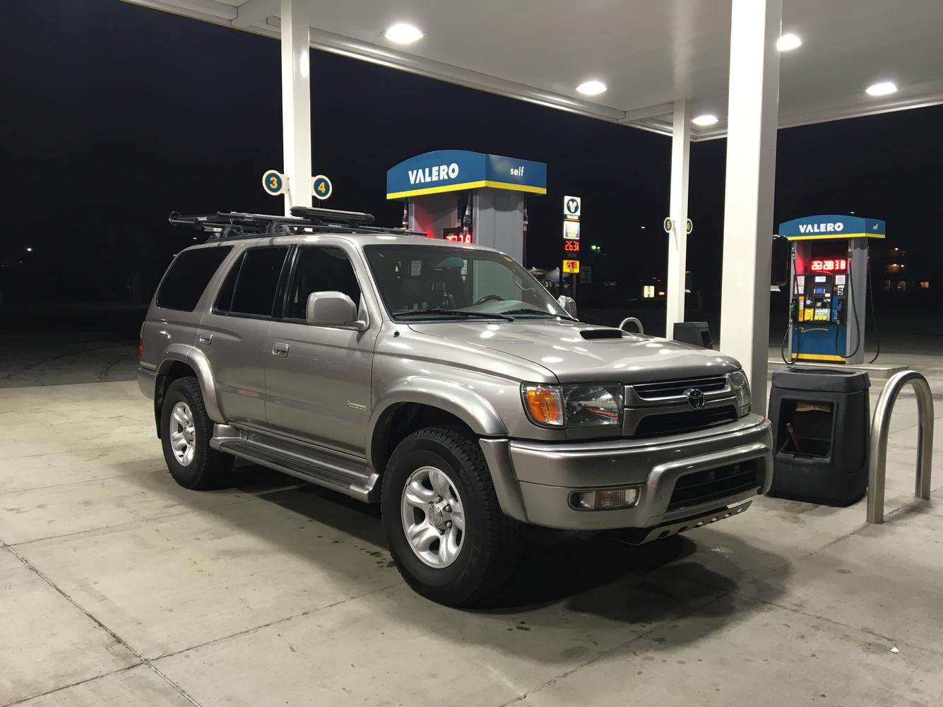

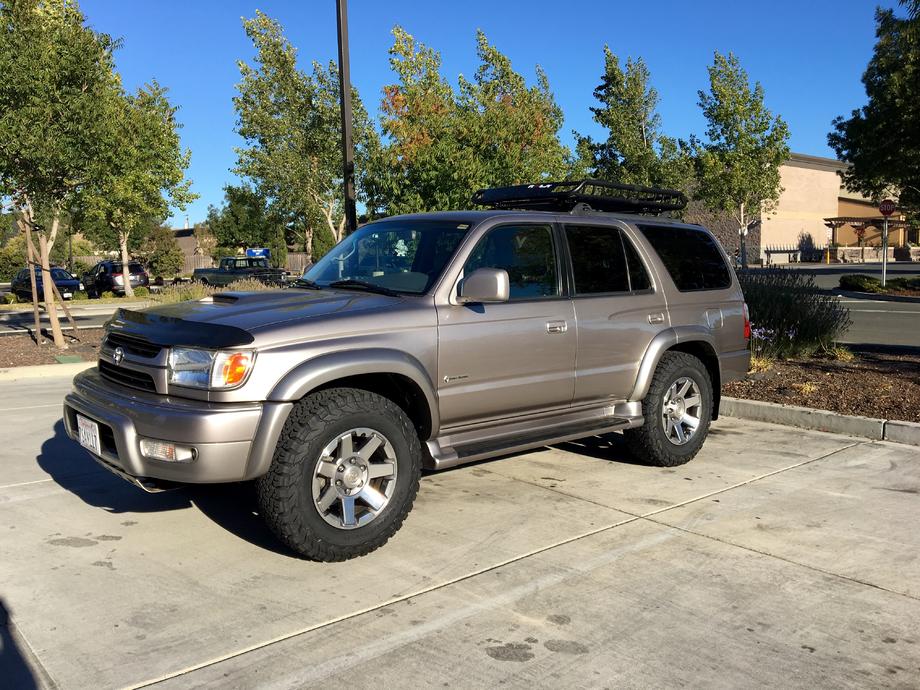

Last upgrade for a while
So I'm pretty much at a point to where I like how the truck feels and sound and pretty much a performs. I got a killer deal on some new tires so I decided to pull the trigger on some bf Goodrich k02 in 265/70/17 load range E. I got a set it 5th gen trail edition wheels a few weeks ago so I mounted them on and I really love the way it came out. The next upgrade will be a super charger but I'll have to wait and do my hw before I pull the trigger on that.
Heres a pic I took today at my local autozone right after I picked her up
