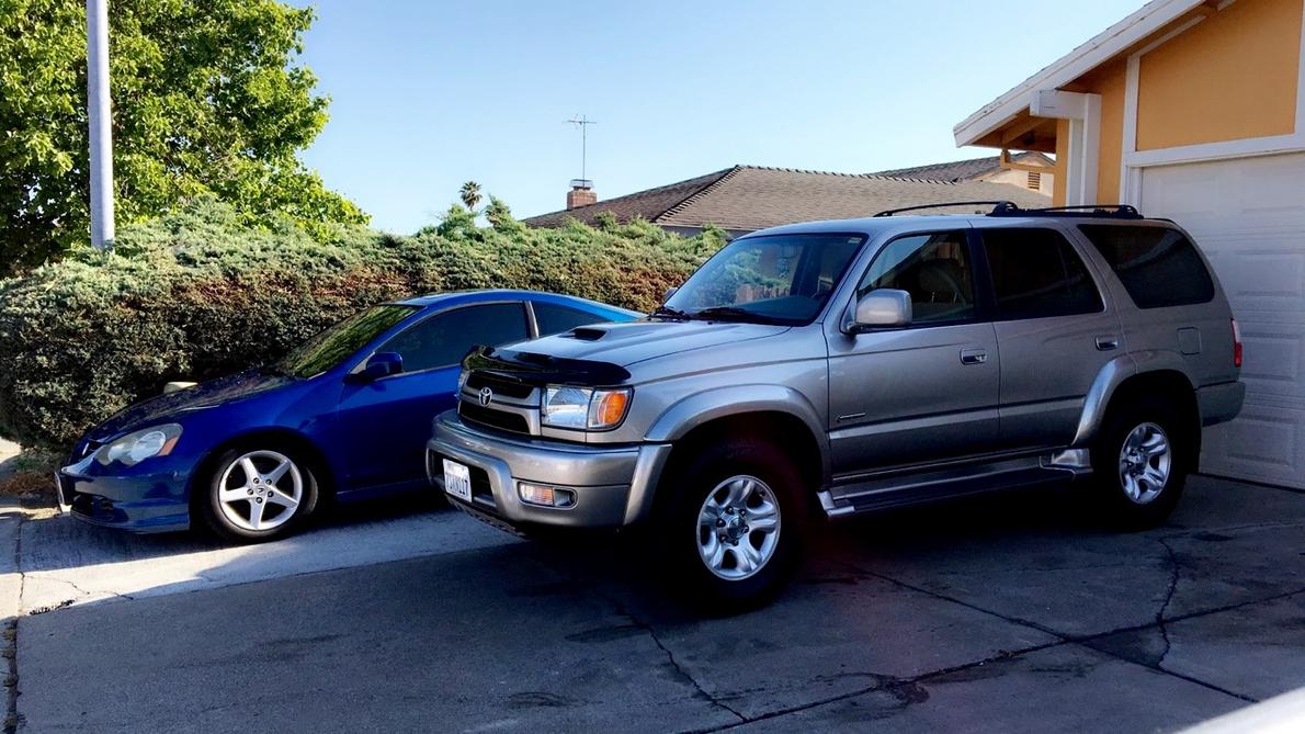

So I've read a few threads and posts that 91 octane isn't required on the 3rd gen. I have a 02 and I've been running it with 91 octane since I got it. And honestly I've ran all my previous cars with 91 octane. Specially my 04 RSX type S that I've had brand new. Mainly I run it because I heard it's the best gas for your engine, and I've never had any issues with my RSX
So is it true that it could be overkill to run such rich fuel?? I know you're suppose to run 91 on a super charger engine but mine is completely stock at the moment
Anyone care to elaborate if it's true?
My 91 octane babies :boink:
