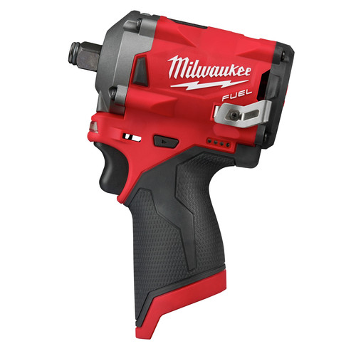

I'm thinking of picking up an impact wrench before I put on my suspension in the near future, and was looking at the Milwaukee M12 stubby since it seems so much more maneuverable.
However, I was wondering if there were tight spaces involved by the suspension where it would even be useful to have a stubby? Or is everything pretty much easily accessible even with a full sized impact wrench?
The full sized impact wrenches offer more torque and are less expensive.

Tbh I dont think it would help too much. I have the M18 Fuel impact and was too big to reach most places except the control arm bolts etc. The bolts for swapping suspension are either to hard to reach and much be done by hand or bolted tight on and needs air tools. M12 fuel stubby impact is really great but is little underpowered for the bolts that are on here. My M18 didnt have enough power or struggled to get some of the bolts off.

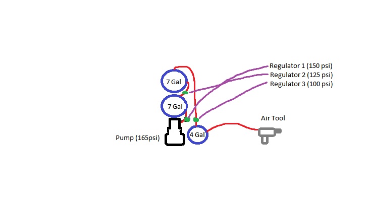

Ir all the way. I built my own system with a 165psi pump, one 4 gallon air as the primary tool tank, connected to two inline 7 gal. tanks on a custom steel square tube rack that I welded together. I installed casters on the bottom so that I can roll it around where I need it. Complete with tool holder and retractable hose reel. Yeah,I was bored. I have an M18 Milwaukee impact wrench, and I do use it for some things, but nothing beats air as long as you have the volume to run without waiting for air.
By running them in a series, I constantly have enough air to do whatever I want to do with my tools, and the pump does not cycle on very much at all. And with only 18 gallon capacity +the 3/8th X 100ft air hose. All of the tanks are aluminum and rated to 165psi as well, so if I want to get REAL, I can crank the psi up quite a bit more.
This is kind of how I have it set up.

I have the 3/8's stubby. Pre-ordered when it was announced and got it the 1st day it was available. It's a great little tool, but once you start using extension and universal joints, it loses its appeal and purpose. It is more than strong enough to rip lug nuts and "clean" suspension fasteners if you have a straight shot to em. Rusted stuff might take a few more ugga dugga's ... but I still turn to my M18 1/2" mid torque out of habit. Why wait a few ugga duggas when the M18 can just rip em off. And the mid torque isn't that awkward to finesse in tight spots. Different story if you have the big boy high torque.
The only thing I don't like about the stubby is that there isn't much of a nose behind the anvil. Throw a short wall socket on it, and it feels like your hand and tool is pressed up against whatever you're working on. The "Gen 1" M12 3/8 impact had a bit of a nose on it, allowing you to fit the tool into more limited spaced areas. The "Gen 2" sacrificed the nose for a smaller tool, but in turn got fatter with girth.
Ultimately, both together are great if you can swing for the M18 and M12. If you have to choose one, look at the M12 vs M18 line up of tools and decide by which battery line you'll want to use more. Dang Milwaukee batteries aren't cheap. Plan ahead for other power tools you'll want to buy, and go from there.
