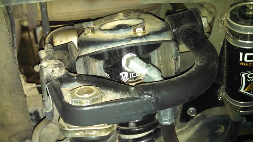

Here is a pic of the orientation of my lines with my light racing UCA's

I just looked at a picture of your fitting for the reservoir hose is totally different than mine. Mine is like [MENTION=23862]masson74[/MENTION]'s posted above.
This is how mine is... I had to put swap the coilovers passenger to driver, and rotate them as such. Like this they hit just at the end of the droop cycle. As [MENTION=23862]masson74[/MENTION] has his (how mine were) they would hit at ride height.

Yeah, yours is different than any I have seen. I posted a picture of mine in an edit to the post above.
Here's the picture from the instructions...
As you can see theirs is even different than the 2 posted in this thread. It just drops straight down.
And looking at [MENTION=74071]Brilliant[/MENTION]'s build his are yet ANOTHER different setup. It makes no sense.
[MENTION=63487]A.Wilson013[/MENTION] What if you flipped the hats over and swapped coil overs left to right. That would move the reservoir tube.
I did this when installing mine to get more clearance.
