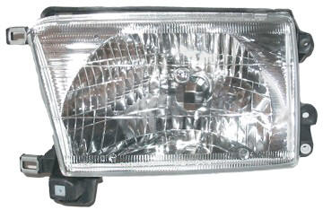

yes, basically what toyota did, is they changed the lens... instead of having all of those cuts or "fluting"(those lines in the casting, that go up and down and side ways and angles ect -they help channel or disperse the light to where it needs to go ) in the lens that the 96-99s had, in 00-on they gave the trucks a perfectly clear lens and made the reflector have all the cuts or fluting in it, and it works better, the fluting in the lens "soaked up" some of the light output and you would lose some light.
see the difference?

if you do the swap, id also throw in a set of PIAA or IPF bulbs, like other people have said they are the silvania silverstars but they dont last and for the same price you can get PIAAs, they are the bang for the buck IMO they have done a ton or R&D and their lights are used around the world by professional race teams from WRC, 24hr LeMans and SCORE truck series... they are DOT approved and only draw the 55/65w that your stock ones do but put out the light of a 110w bulb, and its clean white light, not faded yellow or blue like the HID in non projectors. you can get a set or PIAA h4s on ebay for like $40-50 all day long if you cant find them at an auto parts store, and you will probably pay more like $60-80 at a store for them... check out their web site PIAA
