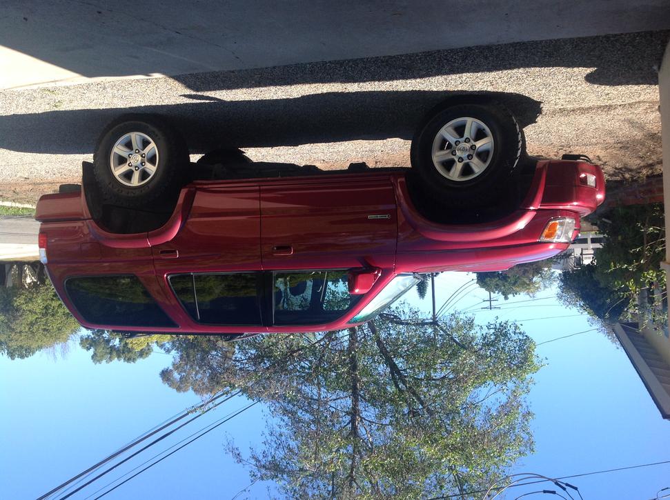

This is my 02 with a 2" lift ( 5100s & ome ) with 265/70/16 Grabber at/2s. Sorry about the upsidedown pic.

RedSled, have you measured that lift? It looks like a lot more than 2" in the rear. Mine looks like that and I gained about 5" in the rear.
