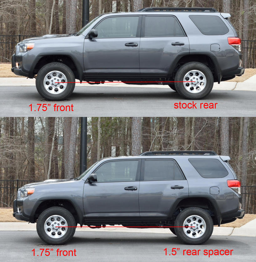

Just finished a lift using height adjustable bilstein 5100 shocks and spacers, and not only does the truck look alot nicer, but the ride quality is much better. Significantly less nose dive when braking, and far less "rock and roll" when crossing diagonally over driveway aprons, speedbumps, etc. feels more stable in the corners too.
Because this was a 'two birds with one stone' mod, I feel the $500 or so was well spent. I've been very happy with the way it turned out. I should also note that while I would've loved to do more lift and bigger tires, I wasn't willing to sacrifice fuel economy, as this is my daily driver. With the stock tires, there's been no measurable change in fuel economy, and as I mentioned, handling actually improved noticeably. Its actually a better daily driver now.
here are some pics/specs:
http://www.toyota-4runner.org/1646874-post1821.html

I'm not spacing the rear, been waffling on the 0.85 or the 1.5 for the front. I like the way your 1.5 looks!

perhaps this image will help as well. the red line is drawn between wheel centers to better demonstrate what is/isn't level... also worth noting, there is no 1.5" setting on the bilsteins. 0, .85, 1.75, and 2.5
