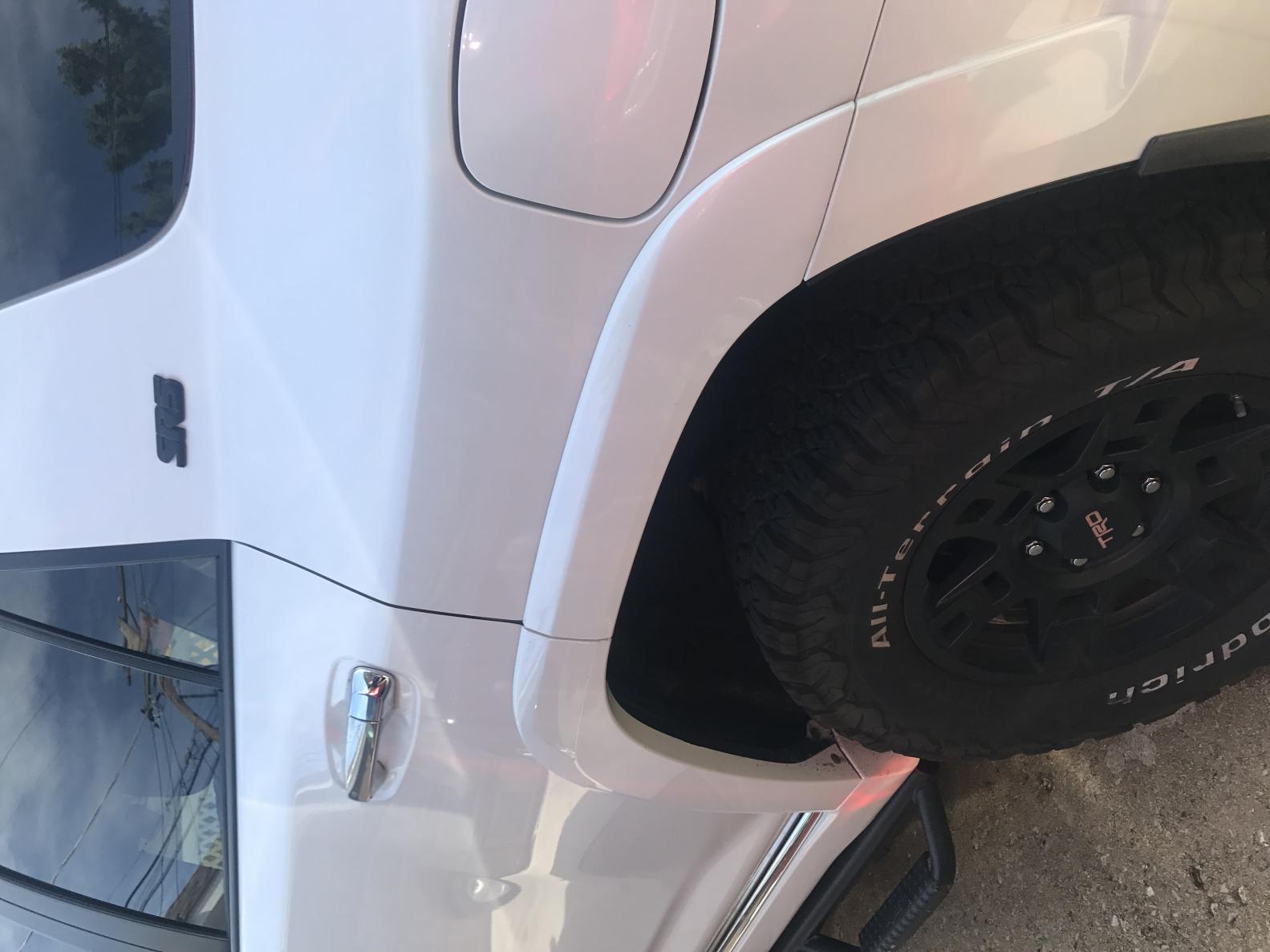

Measure and post the distance from the center of the hubs to the bottom of the fenders.

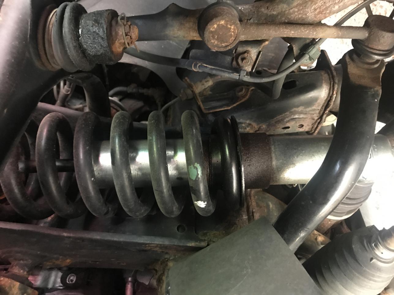

Got about 22.5 inches in front and about 22.2 inches in the rear. Here are some pics on the height.

that strut is definitely leaking, and not serviceable.
procomp doesn't make shocks and struts, but they do rebadge cheap ones.
Some bilsteins as Saker recommended will offer adjustable perches like the one in your photo. 5100's can be purchased for all 4 corners for $400 or so. The larger 6112's are a bit more.
It's not a big deal, and it looks like your non-serviceable suspension has reached the end of its life. I'm guessing that the rear either has a spacer on the coil spring, or longer springs. (rear springs are cheap- and definitely worht the upgrade if you're changing the ride height)

Yup they are leaking. Think I could just swap out some Bilsteins in there? Install the current spring on the bilsteins? Because I want to keep the same ride height

You have stock springs on your front suspension.
The spring perch is hard to determine if it is higher than stock location. If it is, that would raise the front end up. If it is located in the stock location, I would look to see if you have spacers on top of your shock/spring assembly.
